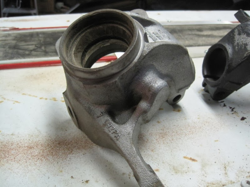

So I decided I should finish the front uprights and hubs this weekend. The ones I had looked to be in really nice shape, even looked freshly painted. Unfortunately, when I scratched one of the hubs with a wire brush, it just flaked off... not going to cut it:
So I wire burshed it off, and got ready to put some paint on it:

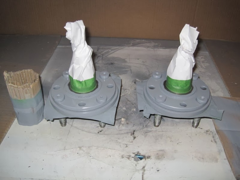

Masked and ready to go:
mmmm paint:
The uprights were just as bad, the one on the right is the one i tested to see how the paint was. They are pretty complex, so I just stuck em in the bead blaster. It took about a minute to strip one. Last part that large I did with sand (glass beads are in there now from when I was doing some aluminum) took 5 minutes. Just flew off.
Pulled the old bearing shell outers from the uprights, masked and primed:
color:
One outer shell driven in, and the inner just sitting dry:
Then I drove the other 3 shells, put in the outboard inners and drove in the seals... in that order. I did accidently drive in 1 seal without the inner bearing... they wont go by the seals, so I had to drive the seal out. I managed to do it without damaging the seal, so I was able to re-drive it in. I pre-packed all of the bearings with a good quality synthetic bearing grease, and then packed the cavity as well.
Here are 2 finished assemblies. I still need to torque the nut. I can't find my socket for this size of nut so that needs to happen and the dust covers need to go on. The nut gets torqued to some ungodly amount, something like 275 ft/lbs. I am not sure my torque wrench goes that high, so I may just use my air impact and call it good.
