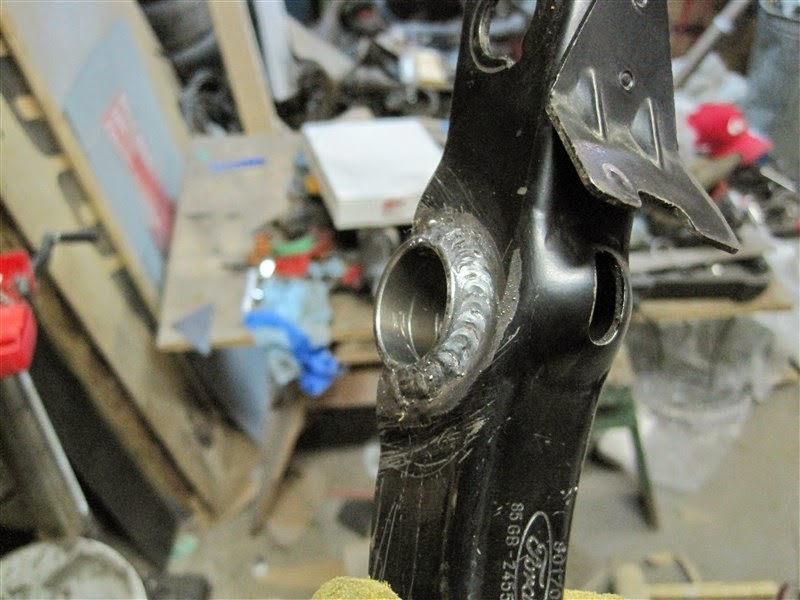

I also started the fairly fun task of doing the brake system. This is going to be a dual master setup with a balance bar, so I needed to start by modifying the pedal box.
First up, cut a giant hole in the pedal itself to receive the sleeve that the bearing will ride in. Note: if you are doing this on a sierra or XR and end up modifying it like mine (there are bolt on kits you can get which save time...) then do yourself the favor of making sure that the sleeve is a good 1/4-3/8" (5mm for our metric folks should do it) further back than where I put it. mine is JUST far enough back that it will work, but I'd sure like more thread engagement.
Pedal needed to be squished in a vice so that the sleeve would fit width wise:
weldy weld:
I used a sponge and a bolt with some sandpaper to ream out the inside of the bush a bit to get the bearing to fit. I also ground down the weld where it went past the bushing. The clevis almost touches the side of the bushing when it's installed properly:
This was a bit of guesswork to get to this picture.

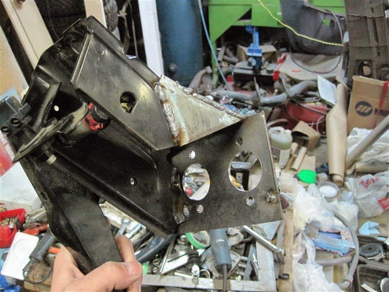

Here is how I did it:
1. Cut some 3mm plate
2. Decide where you want the first master. I looked at the firewall, which showed that for the existing mounting of the pedal box, I had only an inch until I would run out of space to the right of the pedal box... so I went a 1/2" in on the plate, and that's where I wanted the edge of the biggest hole. Based on your balance bar kit, you then space the centers of the two masters apart how far they tell you. Mine was 2 1/2" spacing.
2. Scribe up the hole locations for the masters that I had which is: 1 1/2" center hole, bolt holes on 2 1/4" centers at 9mm or so (I'm using m8 bolts once all is said and done.)
3. Drill everything. 1 1/2" centers are tight for the wilwood masters I have. They should really be 1 9/16 or 1 5/8 so that they more easily clear the boots that are on the masters. I can get them in, but to get them out you just have to pull the boot off of the master (really easy to do). I may open them up with a die grinder before I am done.
4. Re-assemble the pedal box, then use the back mounts (you can see where they were on the left side) to rest the plate on it. You can then Visually line up the balance bar sleeve with the gap between where the masters will be. I trimmed one mounting location to allow me to put in a master to check to see where I wanted the plate in the vertical. I opted to have the master cylinder rod at an angle with no braking, and then straighten, rather than have it straight when not braking. Don't know if it matters.
5. Once I was happy. I tack welded it to the mount and checked again. everything looked good.
6. I then re-enforced from the top of the plate to the top of the pedal box with 2mm plate
7. I then cut away the right hand mount in approx. the line that the master would follow
8. I tack welded some re-enforcement and then welded the whole thing up.
Here's everything trial assembled. Note the carriage bolts that will be changed out for welded in 8mm bolts once I pick some up.

Offer that up to the firewall ASAP to check the pedal postion..
'Memeber I said when we did those cars way back we found we needed to extend by appron 22-25mm the pushrod length to get the pedal higher
And whatchoo talking cut a hole in da firewall, mang?
ADD a 1/8 plate on the engine compartment side, then drill holes thru and bolt that contraption THRU (zap the bolt heads so you secure whole shebang from outside, not inside laying on back reaching up.
Oh and fill that hole in the firewall..a hole-saw drop out is fine. Zap then sand down (leaving the pilot hole for a center point for referencing things..)
Pedal position is 100% the same as stock. The pushrods are juuuuusssst long enough to allow it to be fully extended on the stock front pedal stop.
My thought is this: Hole in firewall + welded bolts in the plate = allowing me to set up the masters and ballance bar OFF the car, put it in the car, bolt it up with nuts in the engine compartment and be 100% good to go. Servicing then would only require unbolting the nuts, removing the two brake lines and clutch line.

BE CAREFUL. firewall is flexy. The push comes from the back (in) side. Simple me thinks I'd want the plate in the back (in) side overlapping the front flate..
I dunno...but think flex.
