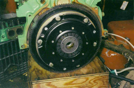

It's one of those funky CIH things....
Been using an off-the-shelf (cheap) 7.75" Ford 2300 circle track PP (you know, with circumferentially-located mounting tabs rather than the Lepo's radial-mount tabs which always snap like spaghetti), and a custom made disc from a So-Cal shop. Works great, lots less inertia, holds 200 ponies with no issues, and has light pedal pressure. And it's already Kawi green...
Here's a lightened stock flywheel I prototyped, but I get squirmy thinking about using it for racing. So I want steel for the real world.
Uh, uh yeah...
OK, I guess you pass as long as its Oldpile. Maybe I can make a coupla extras to bump the numbers up for those 2 motors that Clarkalainenen Doivi has seemingly abandoned,
just one question: who the fawk is using MY COLOR on some pressure plate??
Is that the pressure plate i think it is?
I think it's made by Zoom for Speedway Motors. 'Mini-stock 2.3 Ford' is the application. $85 for the pressure plate, and the custom disc was $130. Both new, not rebuilt.
The pressure plate is 2 lbs lighter than the stock 200 mm Opel stuff, and the lightened flywheel is now 15.5 lbs, down from 22.5 lbs stock. But I didn't go thinner than .500" anywhere. With steel it could certainly be lighter.
Hmmmm 200mm my default n.a. clutch has been for years the thing the Swedes used on 200-210 bhp CIH rally motors and that was B21T Volvo pressureplate.
Now-a-days Sachs has commonalised Volvo B21T and Saab 900 Turbo pressure plate, both being physically same bolt up and dowel.
I presume their idea was if it works for the ft/lbs of a good turbo, it'll work fine for n.a. higher BHP---but still limited torque---motors.
My favorite 200mm thing is doubtless VW aftermarket since i can get Kennedy Engineer Products and I know they are honest with their torque ratings:
and have available several ratings.
