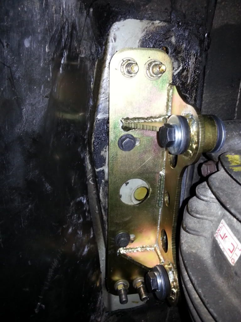

Ok so I didnt get any inserts to weld into my floorpan for the diff-body bracket. Any harm in just running the stock mounting hardware and calling it good?

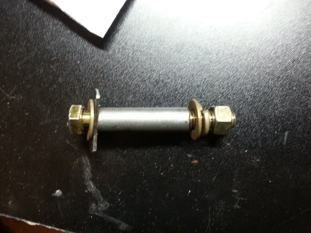

I got my kit in this last round John. My concern with not having a weld-sert(weldable insert) is crushing the formed sheetmetal "beam" that is tack welded to the floor of the car that the stock thingy bolts to. That would be assuming I put a bolt in the trunk and a nut under the car or vice versa.
If thats a non issue then I will just drill and use some bolts.
If its a dangerous issue by only using the stock points and crushing is an issue what I will likely do is just find some thick wall tubing and use them as an insert to slide over the bolts and use as a anti crush setup.
I'm not trying to cause issues or anything just trying to solve issues percieved or otherwise in the field in a timely matter. This car will drive by Friday morning!!!!!!!

Pics to follow soon of my solution. It is a weld free solution to the diff mount points

Okay so I got it all put together. I have a vibe. ALL THE TIME now. I'm thinking I will try getting the shaft balanced and go from there.
Anyways I am about to post pics of what I did in regards to installing the diff.
