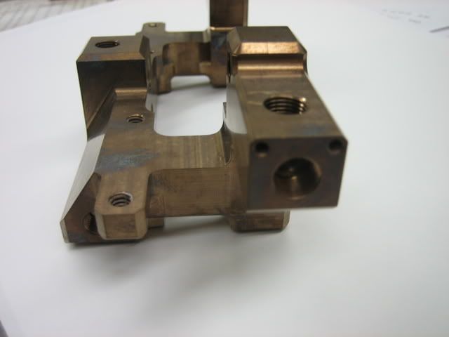

This high pressure manifold is 17-4 H900 after a 1 hour bake in a Nitrogen flooded oven:
Re: Closeup component pics from WRC Spain
October 14, 2008 09:57PM
Tim do the aerospace companies use hydraulics or pneumatics to perform tasks like closing doors and remote actuation.
That manifold is most likely for some high pressure gas or fluid..Do they build this stuff to be WAY OVERKILL to prevent failures or does it need to be that strong because it's under such high pressure and stress?
