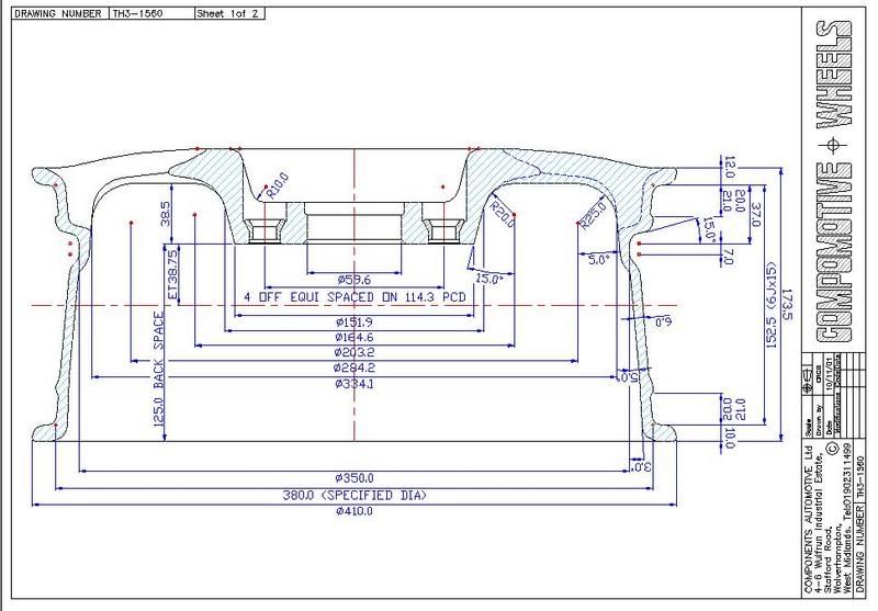

Don't just order wheels and then "space" them if they don't fit your brakes.
Verify brake clearance before you order them.
Follow these guys' recommendation and use the narrow wheels. You'll be slower on the wider ones.
Get a nice big long formaguage http://www.mclendons.com/item.asp?sku=11072560
and capture the contour of the rotor hat along with the caliper. Trace it on a piece of posterboard and cut out the contour.
Have the wheel company email you or fax you the section of the backside of the wheel you are looking at in the desired offset. (Make sure they either put grid lines on the drawing or put a scale in both X and Y. Sometimes faxes don't transmit at 1:1 in both directions and who knows what the scale of a Jpeg might be if they email it.)
Print out the wheel section making sure it's at 1:1 scale and test fit your brake section.
Save your brake template in case you see some wheels for sale and you want to check to see if your brakes will clear.

Yeah I meant PGT.
I haven't ordered anything yet. I'm consulting you guys with more experience first.
I built my brake upgrade around the current wheels I have. Which I'm going to keep for tarmac events. They'll have less clearance than true motorsports wheels which are designed for brake clearance from what I've seen.
Comparing my brake setup to Tim Taylors setup for example. He got away with running considerably less spacer than me. with 15x6 et~38 TH3 compomotives.
15x6 with 14/62 looks like a good setup.
Re: Newb Rally wheel and tire question
November 08, 2008 12:32PM
Good advice. I'll have to get some real prints from the wheel manufacturers.
I can model the wheel and see what works best.
November 08, 2008 12:33PM
This is as big as you can ever fit in a GTX without huge sheet metal work and you still need to roll the fenders to do it. Plus this keeps the stock scrub radius with 0.375 if brake top hat thickness.
I've run with as little as 4mm of brake clearance, but have had rocks machine grooves in both the wheels and the calipers when I've done it, so I'd recommend more.
