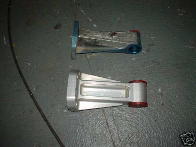

MOST serious rwd cars did some variation of something like this:
(look down below manifold)(and the sheet metal chassi rail mountings welded in so the motor is mounted to the CAR, not the crossmember, and a wide base):
Earlier--1990 spec welded up 909 mounts:
Later, 94 spec more expensive to make Billet 909 units:
Clear drawing of the concept:
Here's a Capri I did with the chassi rail part (and a very easy to make and vital little gusset between the chassi rail and the firewall):
Here's Duratec I did mounts inspired by the Sierra early mounts:
This sis something like what anybody who wants a car they can pound for years and just forget should aim for:
Here's Volvo versions:
Hope you noticed the extensive stitch-welding....
nudge nudge..

Here's Group B Celica stealing a page from Ford:
Here you can see the mount sticking out...
Clearly it is an area that is addressed and done on rally cars completely differently than road cars.

Holy crap, pretty sure you could hang another car on those mounts.
So, I guess the point is go for stiffer, but with some vibe dampening.
