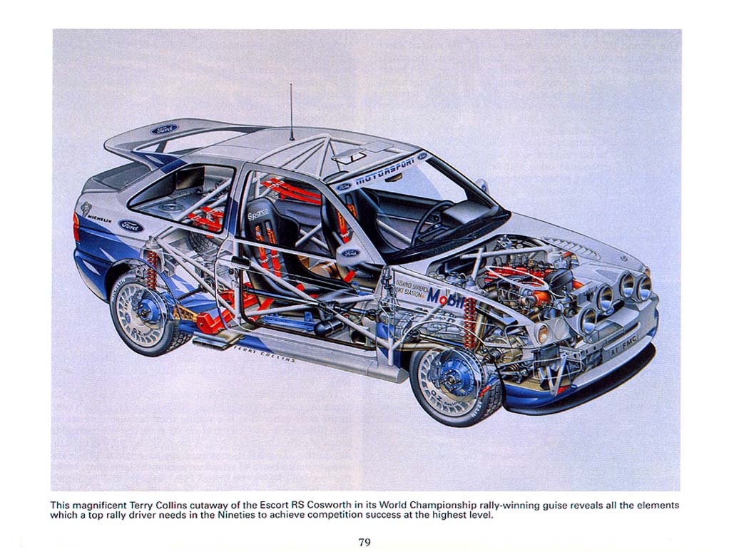

Just have to finish the new X required in the main hoop, and then figgure a way to get it back into its' wintery storage space (and perhaps take some better pictures actually showing something...). Nah...

Paddy, chop out those little useless triangles in the juctions of the doorbars, they accoplish ZERO and make some proper gussests.
And who came up with the front entire half???
Bizarre, indeed. I guess nobody cars if the whole corner crushes in in a simple roll which in a more tradition, less fuckin creative design, would have nice support to the whole length of the A pillar and on to the main hoop.
And just what the fuck is so hard to grasp about copying the rear stay, X, etc junction the way Ford did things.
Are ALL cage builders so fucking stupid, or lazy or what?
Can't any grasp simple principles, or fess up Paddy, did YOU tell them to fucking MISS THE WHOLE FUCKIN POINT???????
Somebody somewhere fails to understand really elementary ideas.
What the fuck.
So I may need to use the hammer and welder a tad? Good heavens! The early drop works with the bent roof bar, supporting it more in the middle rather than relying on the ends to hold it up. If that center bar gets bent in a simple roll, it'll be a much more costly repair than just grafting on a new corner. Should be same effectiveness in a large roll in either case.
> Ford did things.
> or what?
> FUCKIN POINT???????
The rear was a cost comprimise, as you know it is hard to mitre all those pipes to meet at a small junction area. Shock loads are still transferred through the bolt to the small tower body, then what? It either pushes up on the cage through your top-mount idea, or it must pull the area below it where mine goes in. Provided the mini tower gets plated, I don't envision the shock coming through the top mount in either case.
> elementary ideas.
> What the fuck.
Hug me?
