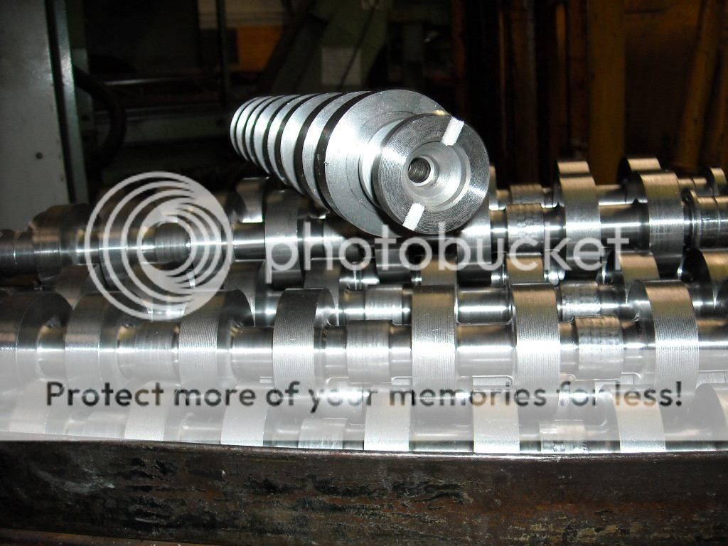

Well it was the lack of suffciently large cores for putting lobes worth a damn that drove Lawrence to decide to make cores with big circles where we could make any crazy profiles..
I did the machining and saved him 2/3 of what he was set to pay, and still made good money on the job..
Here's some piccies from when I did them:
Now a cam like this can be done and reatain the stock geometrt and shim set:

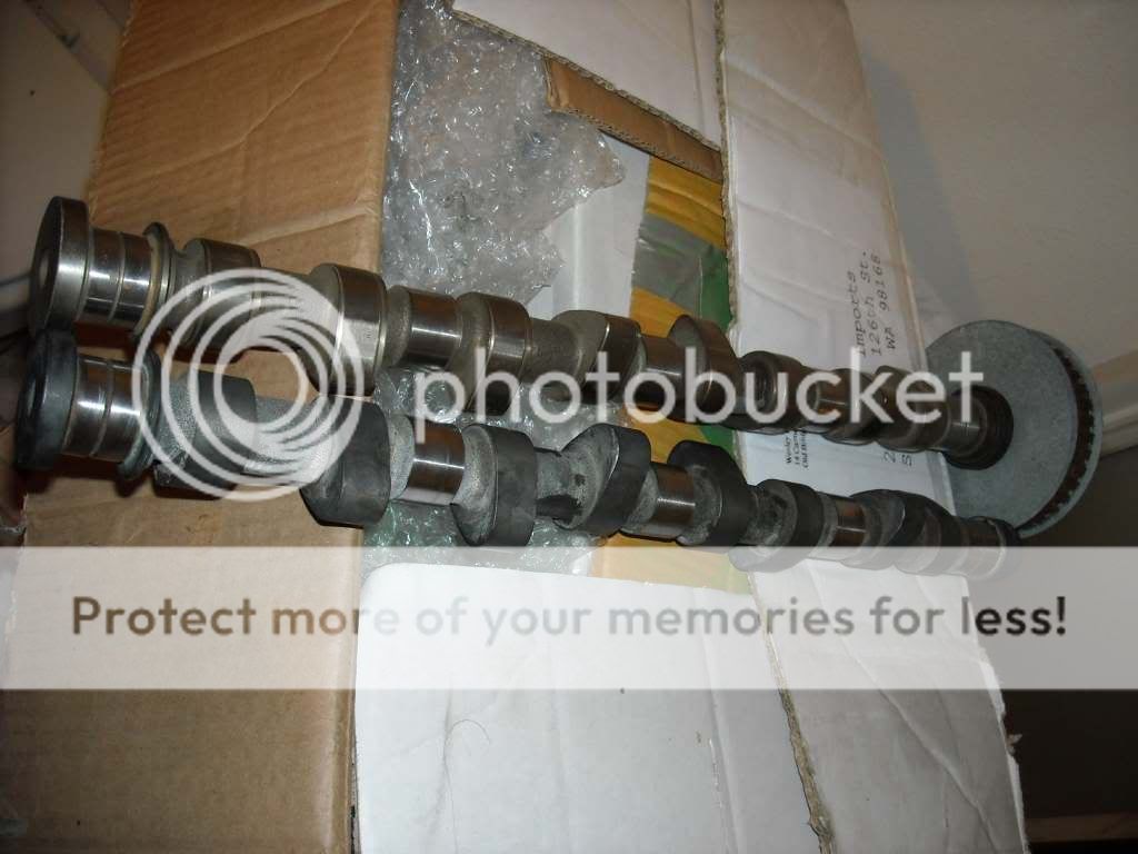

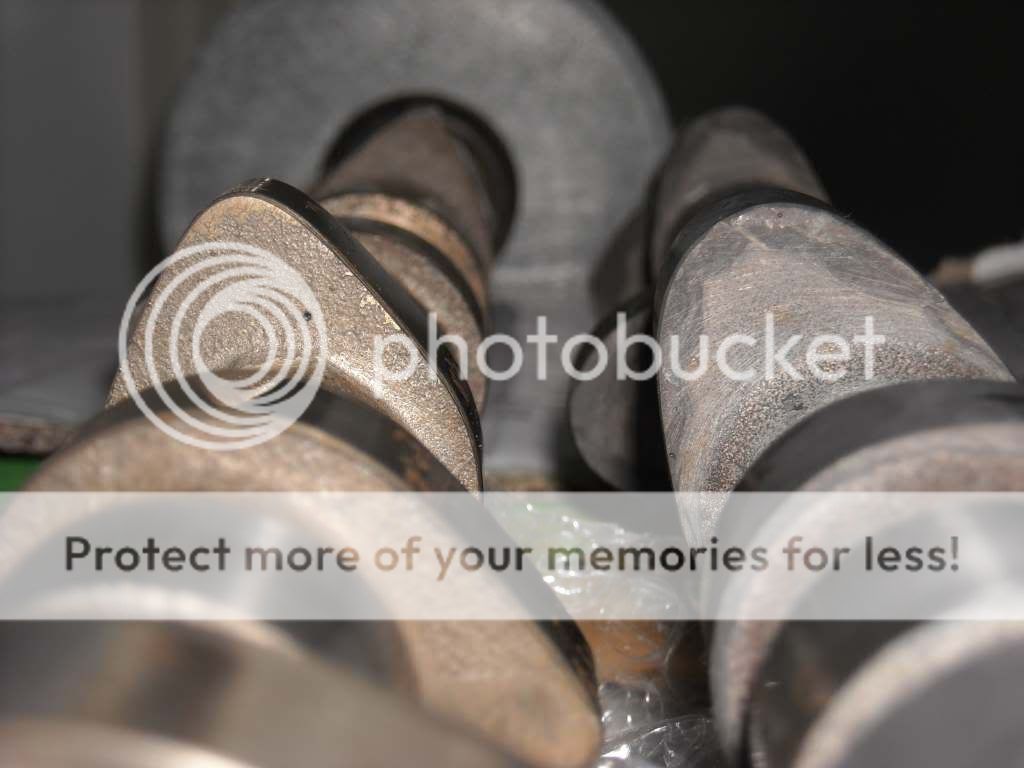

Also what are the things the influence rpm powerband? I know advanced or retarded (lol retarded) timing can affect rpm. But there are still things I don't know
The thing that creates the powerband is:
the shape of the cam lobe.... not merely timing and lift, but the shape.
There you can see a stock whatever emissions cam and a performance cam for rally, quicker and higher opening.
A quicker and bigger gulp of air.
