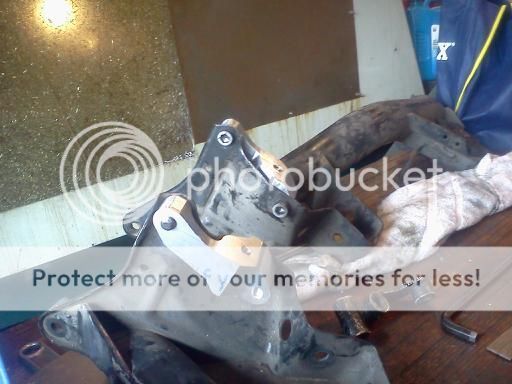

Actually its about 35-40 minutes with a lift and air tools to pop in a Supra diff into the Xratty, even better now that these are done (today)
Supra 8" ring gears, same as Toyota pick-up pr 4-Runner.
Alternate ratios new cost from $137-220....compare that with ANY other final drive for any other car..
Only Dana 30 matches those prices, and Volvo has Dana 30...which a 7.2" ring gear....
So it's significantly easier to install a LSD and a gear of your choice in an Xratty than almost any other car (except old 510s but finding a R180 with suffciently short (4.88-5.1) ratio is hell on earth.)
And you get a diff which should be (if somebody doesn't totally fuck up the install) virtually unbreakable for us.
And windshields, I'm working on it..I'm a busy guy.
