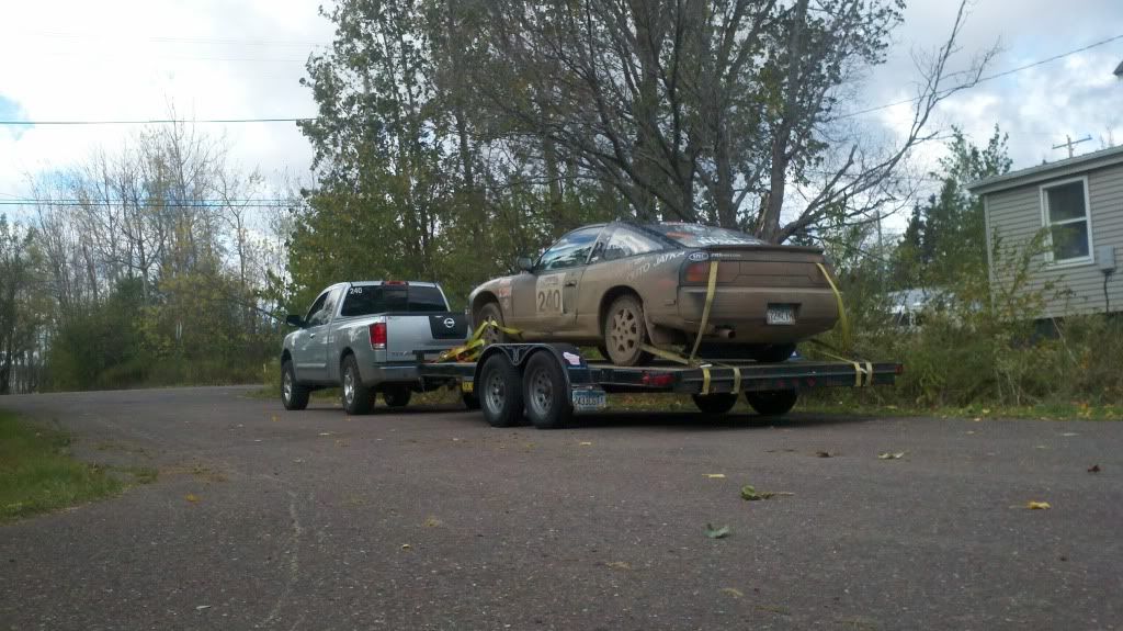

Hello, we are Finnish Fury Rallysport.
We are a up and coming rally team based out of Duluth, MN. We started campaigning our 1991 Nissan 240SX Group 2 car in early 2011. Our first year was mainly a testing grounds to get the car sorted.
I built the car myself from the ground up with a little help from some of my friends, who have also been acting as my crew for 2011. I started the build up in October of 2009.
Check us out on FaceBook. Finnish Fury Rallysport
The full build of the car is detailed here: The 240SX rally car
Here is a short video with some build photos, and in car video.
My name is Ian, I am the car owner and driver. As of now I do not have a set co-driver, but may for next season depending on how things go. My focus for next season, is Max Attach. The car is currently Group 2, and will stay that way for at least a year, although I have entertained the idea of upping to Group 5.
Some of the other team members are Cale Isaacs, and Broc Nelson. Both have acted as crew, but Cale is looking to get into the car any way he can. His long term goals include building a car of his own.
I first got into rally in the mid 90s when my cousin Eric Seppanen was racing his Production Sentra SE-R, which he later sold to Jake Himes. I worked service for both teams, and in later years helped out Dan Adamson as crew. I have also marshalled many times. I am looking forward to getting to know more and more rally people over the next few years.
Its time to bring Real Wheel Drive back to the rally world.
