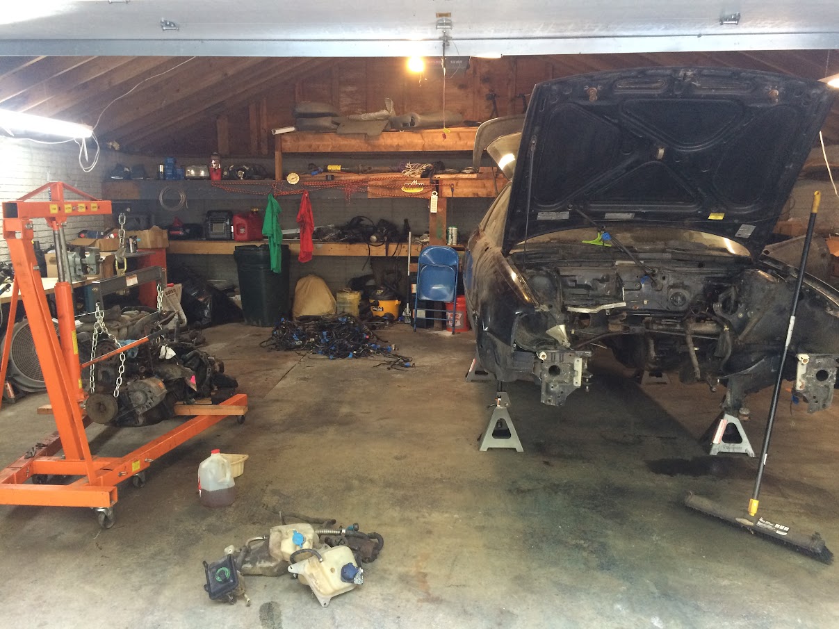

Spent considerable time on the project this past weekend. Biggest accomplishment was getting the entire chassis and engine harness out of the car as 1.
I've got a lot of work to do here laying this out, cutting it up, repairing lines, replacing others... etc. etc. etc. I will update as I go. Big thanks to the contributors on that electrical connectors conversation over in "rally Chat". I've got some good ideas now on how to go about sealing this up.
Engine bay looking pretty empty! More details on my projectpad post, link on my first page

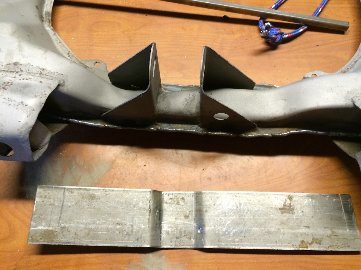

Got some work done last night, finished seam welding the rear subframe.
Now looking at how to go about reinforcing the rear diff mount. I had to make do with only two C-clamps and a pipe for a hammer...
I'm thinking this should do...

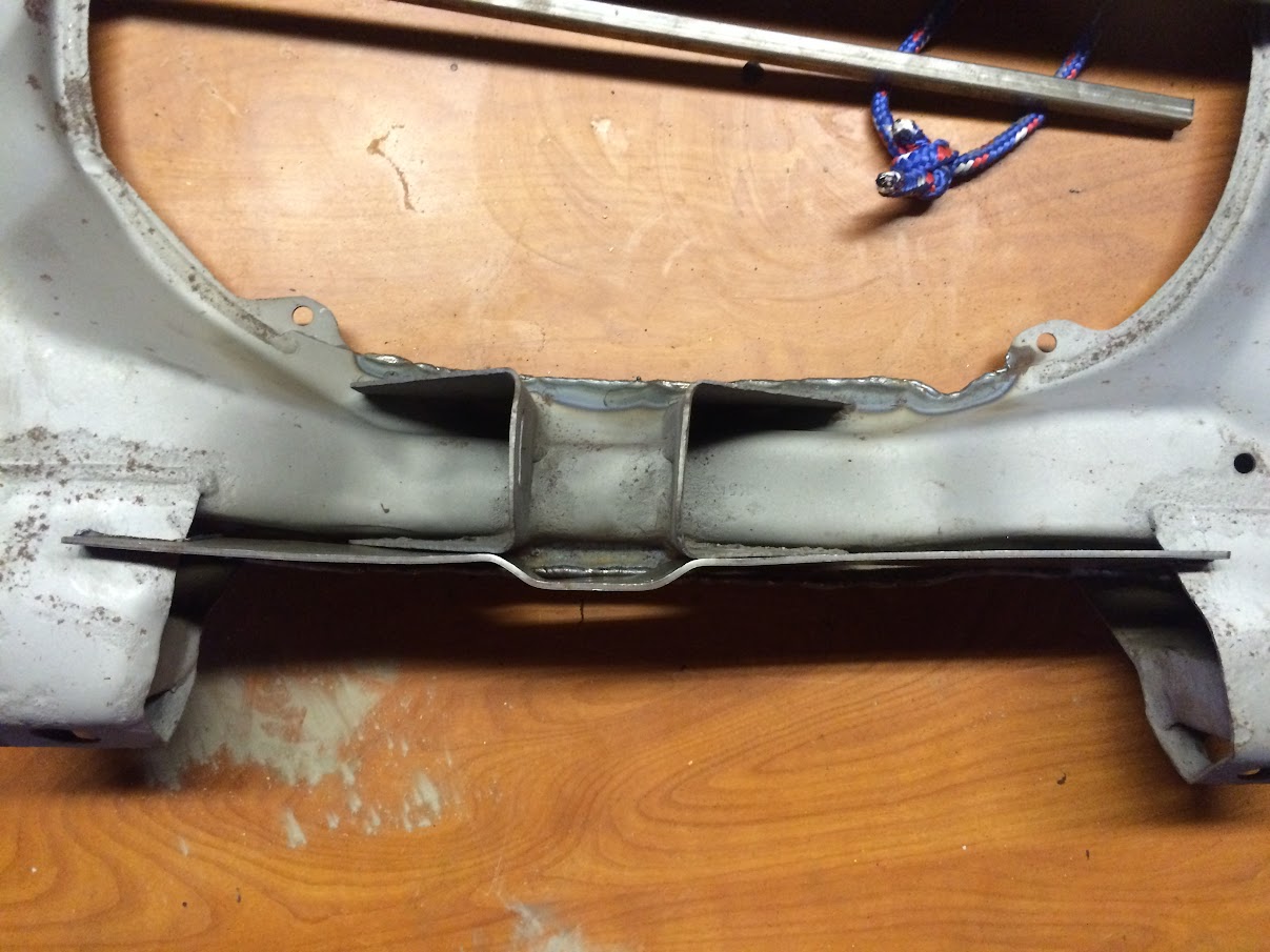

Alright, I had a bit of a marathon weekend in the garage. 3 days, alone but productive.
I'll start with the rear diff mount since that's where I left off. I abondoned my one-piece rear solution shown above. and decide to form two U-shaped pieces that fit inside the OEM mount, and then reinforce one spot outside that was particularly worn away from rust.
Welded up and mid grind...
inside look... I got little bit carried away with the welding - I was really enjoying it!

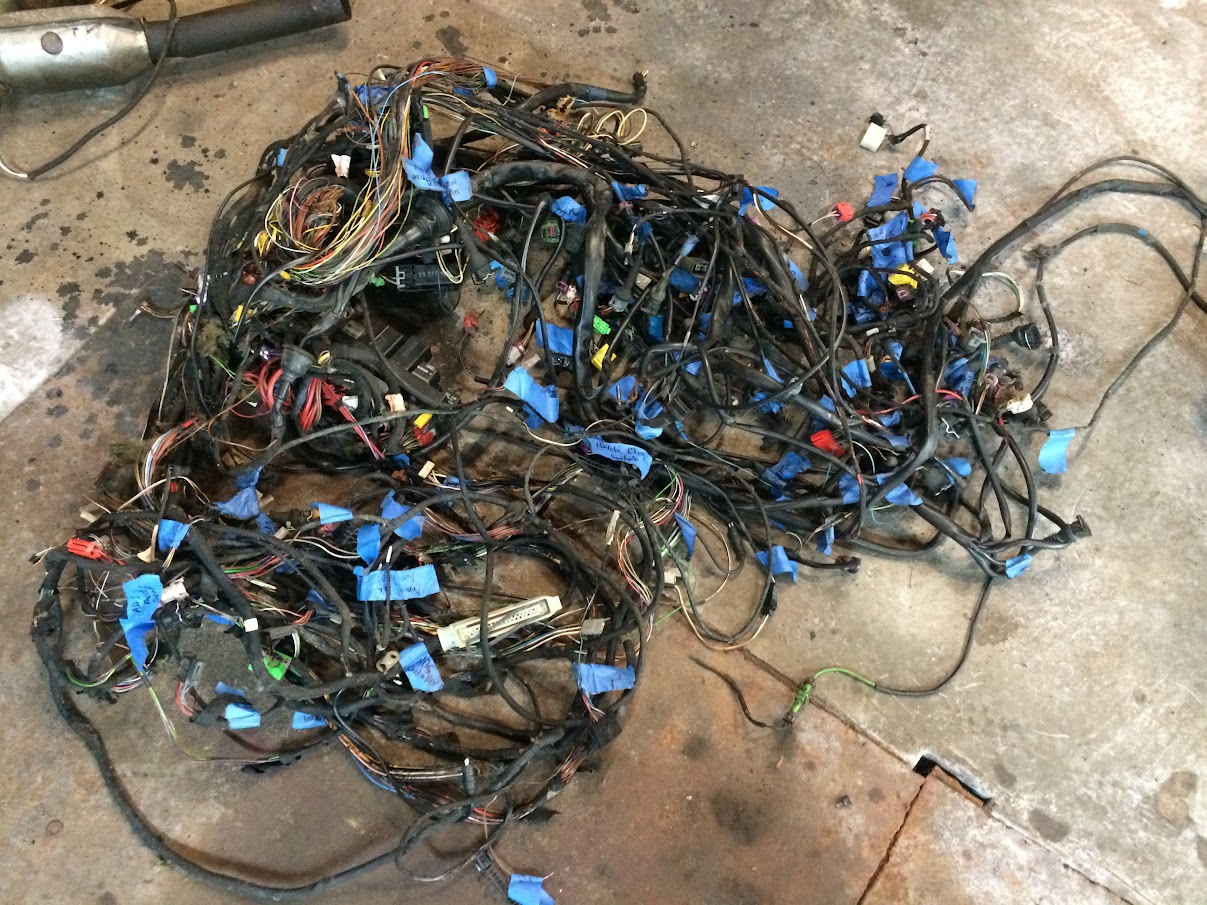

Alright, After two hours on Tuesday tracking down wires of this and that, I had a relay socket that I had no idea what it did. I posted on an Audi FB page and got an answer and that was a huge relief.
The relay socket is for a low oil pressure warning relay which my car does not have since it has a fancy "Auto Check" system - which for some unknown reason, I'm attempting to preserve. Since I don't know how long I'll actually try to keep the Auto Check system in this car, I figured I would leave it - oil pressure is important I've been told...
This means I've identified everything in the harness and it's all labeled - however shitty. This is where the different branches stand now. I estimate that 50% of the wiring in the car was non-essential and removed.
More on this in the coming weekend.

    Tidy up wiring harness further -> connect loose wires, replace frayed wiring, cover connections, protect the long branches, measure out how much Heat Shrink I need... etc.

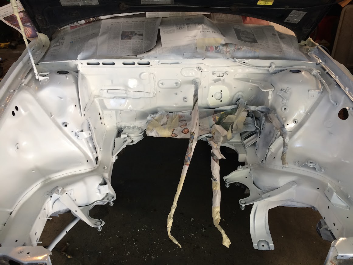

Got a good bit of work in this weekend. Focused a lot on getting the engine bay painted. Once this is done, I can finally start looking at putting things back ON this car instead burying myself in a never ending to do list...
Taped up, scuffed, and cleaned:
Primed:
Paint:
Clear coat and unmasked:
I used VHT engine enamel paint which was pretty good. I was really happy with how it looked after primer but the Paint was too cold I think (temp was in the high 50s) and there were little flakes of congealed paint that was spraying out. I couldn't get them to go away and I was in a time crunch so I had to roll with it. Result is that there is now a bit of texture in the paint... but whatever, its rally car.
