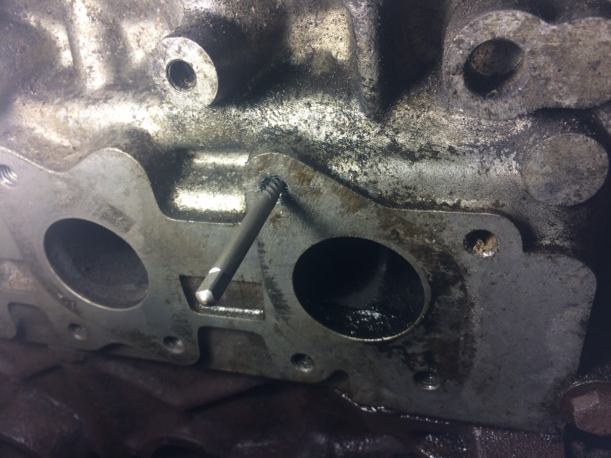

Oh, I also extracted my first broken exhaust stud (in the head). Here's the process in case anyone's interested:
**All these steps were performed after much treatment with MAP Torch and PB Blaster!**
eyeball center and punch it with a center punch.
I have left-hand thread bits just for this purpose, so dril it out, pay careful attn to depth so as not go into the head...
Tap in extractor to seat...
then, CAREFULLY crank CCW, I say carefully because the extractors can only take so much and you REALLY don't want to break the extractor off in the stud. If it feels like its not going to move, reapply lots of heat and penetrating fluid. You can also step up to a bigger drill bit and bigger extractor... but in the end.. whoala!
Also, I should note, that this job mamde me buy this fancy extractor set... but having 3 early 90s Audis in NE, I'm sure will allow me to get my money back... (also I got it on Amazon Warehouse deals for a discount)
