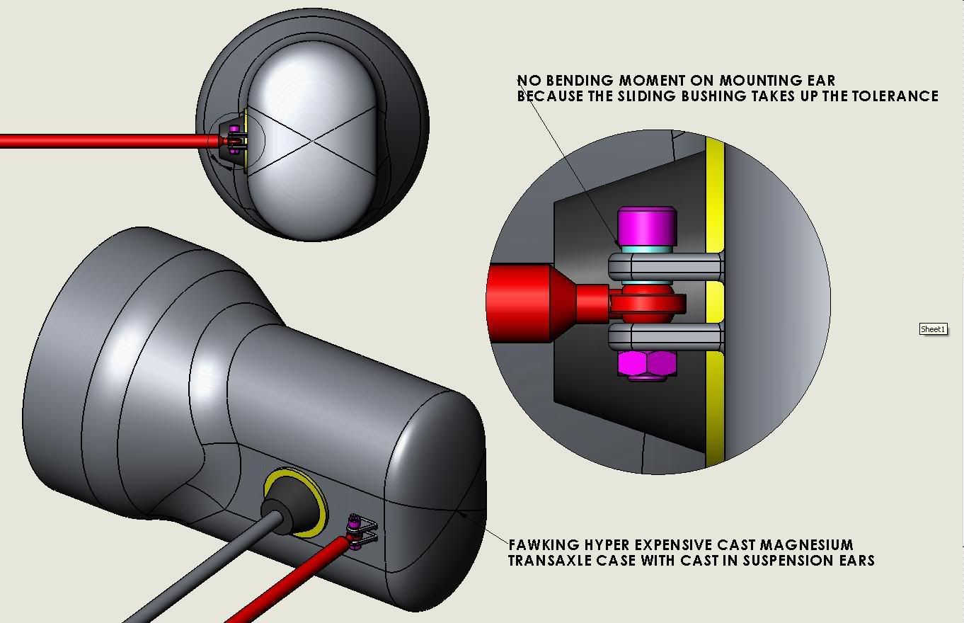

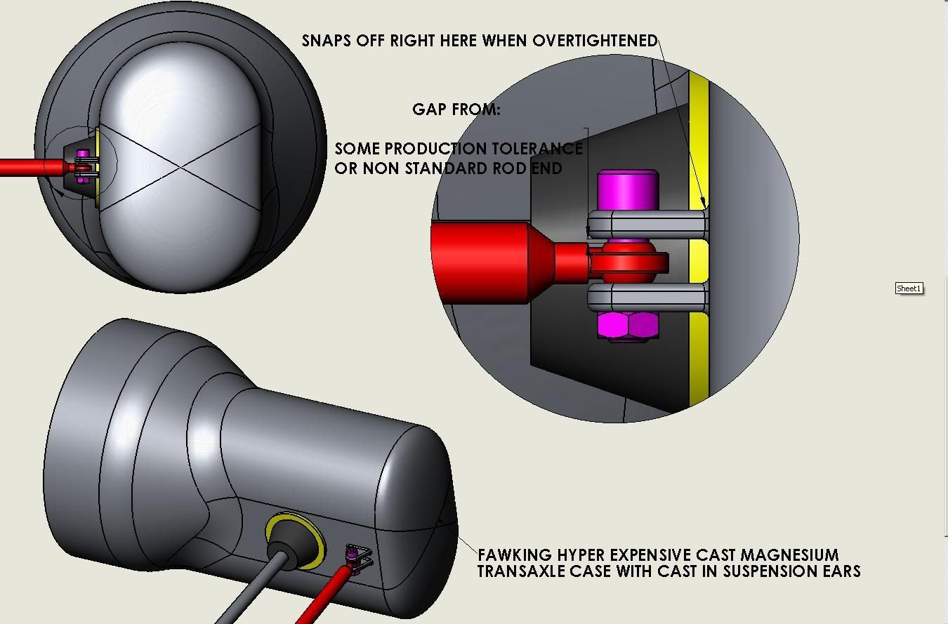

On Adam's model there is a section of box tubing on top of the turret. It has two pieces of 0.75" OD x 0.50" ID tubing running across it where the bolt mounts. One side is welded solid on the outside and the other slides thru a (my question: precision bore or just drilled hole).
It's usually done that way on lightweight formula cars to protect the casting on a transaxle where a rod end bearing mounts. The sliding section of tubing keeps hack mechanics from over tightening the bolt and breaking the ears off. As a bonus it's cheaper to make because you don't have to hold a tight tolerance on the slot.

I don't know why Adam used that design in his application. Maybe he just wanted to play with it and see how it worked...I do that sort of thing all the time. Not everything Ford did back in the day is the end all and be all of designing race cars :-) It is a particularly elegant solution for preventing damage to cast mounting ears. I have a better drawing of what we're talking about below.
The suitability or necessity of the sliding bushing on a ductile mild steel mount is not what I'm asking about. I just want to know what kind of tolerance he has on the bushing fit and while we're at it what's the wall thickness of the box tube?
FIXED EARS:
SLIDING BUSHING EARS:
