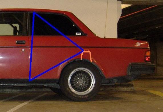

Oooohh, I want to play MS paint too. Here is a fairly realistic rendering of where the current turret install will make the cage land.
Yeah that looks a lot better.
I understand that your truck just got stolen. But this is a DIRECT quote from what I said earlier, "I'm not saying it's a stupid idea. I'm saying from the mspaint representation that the angles don't look right."

Re: Rear Shock Turrets For Volvos
April 21, 2008 10:20PM
Andrew, I'm really not trying to pick a fight with anyone over this, honest. All of the previous drawings had the towers twice as tall as what I'm using so I did another drawing. If I get some time tonight I'll do a real free body diagram of the back of the cage too (since John V. asked so nicely)
Tim
