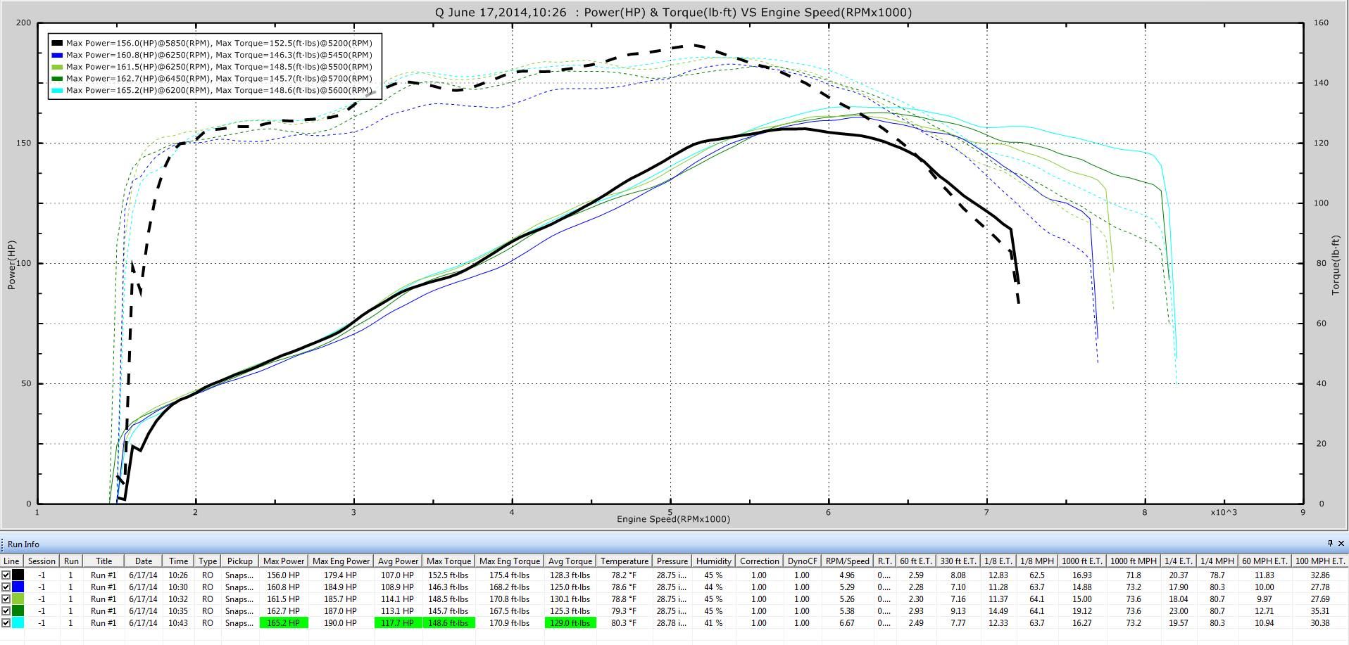

volvo 240
Re: Mazda MX3 for learning and Rally/Ice X seat time
October 30, 2016 11:36AM
tin
What would be an example of ideal or good gearing?
It depends a bit on the engine characteristics, tire size, etc but for naturally aspirated engines this will give you a good idea.
5 speed
1st: 2.337/1
2nd: 1.681/1
3rd: 1.358/1
4th: 1.150/1
5th: 1.000/1
4 speed
2.3/1
1.5/1
1.2/1
1.0/1
For rally these ratios will get paired with anything from a 4.3:1 rearend (turbo, lower revving also a turbo motor will a lot of times have wider gear ratio spacing) to a 5:85:1 maybe even shorter for a seriously high revving motor. Again, depends on a number of factors. -
The 5 speed ratios are copy/ pasted from a e30 m3 group a spec sheet. Same gearbox that a number of teams used (volvo, I think jag, and ford, among others). Granted these ratios are from the 80's but if you go shopping for a 5 speed close ratio gearset offered now the ratios will be more or less the same.
These are examples of ideal ratios. To get them in your car will take a few bucks.
