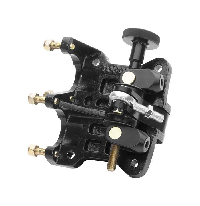

Then I discover that this exists:
http://www.wilwood.com/Pedals/PedalProd.aspx?itemno=340-4630
Neeeet. Balance bar attached to a remote mountable bracket with a built in 1.48:1 ratio lever. That will turn a 4.5:1 pedal into a 6.66:1 pedal. Be simple to knock up a strong bracket that attaches this to the firewall. Already have a .700 and a .750 master, as well as a .625 for the handbrake, to replace the .700 already there.
Niice
