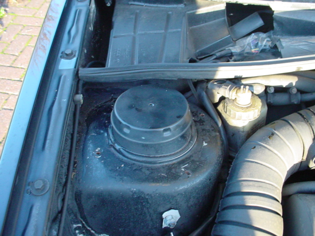

Here a cornvienient piccie from a Subie fan:
Here's a drawing more or less of the cheesy VW/ Xratty design:
Your Golves have the truncated cone bump in the body,
the Subaru mounts have it in the mounting plates.
A bit of cutting out the "volcano crater" and maybe a wise reinforcing of the top plate and drill 3 holes and you're done.
FOREVER.
