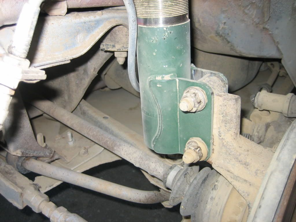

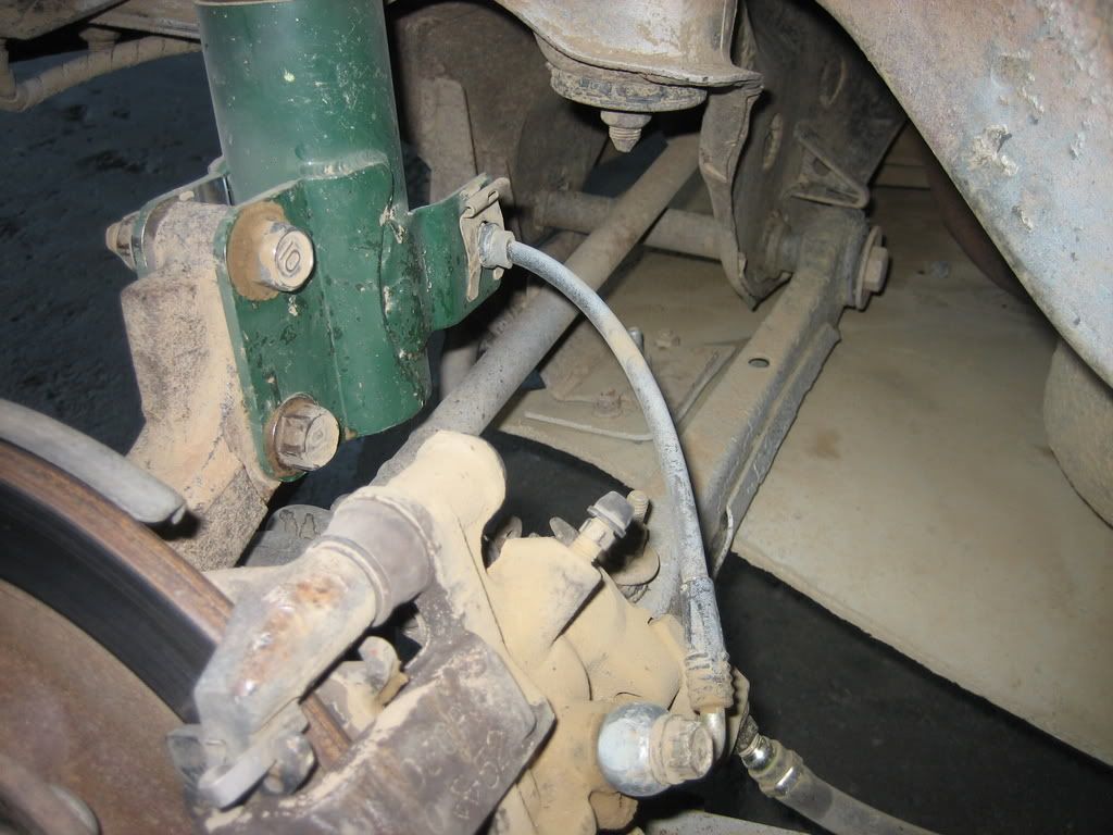

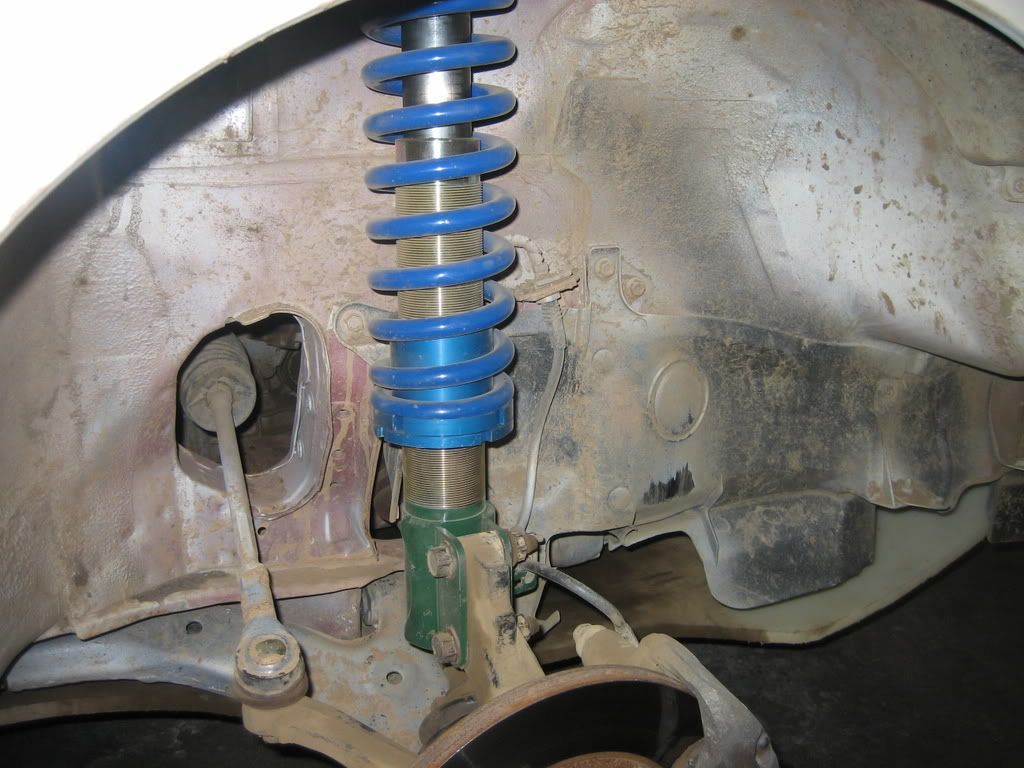

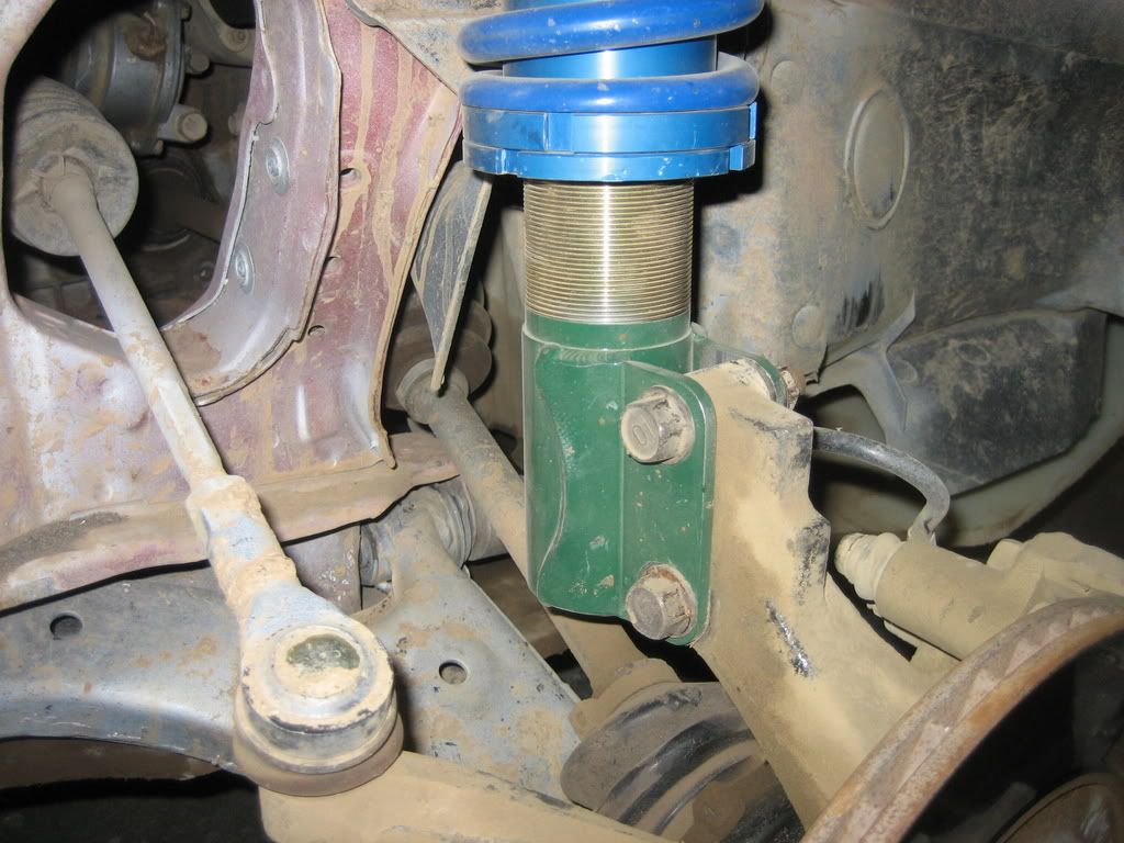

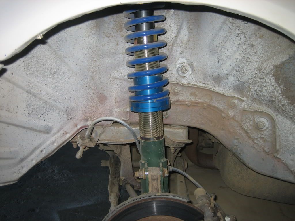

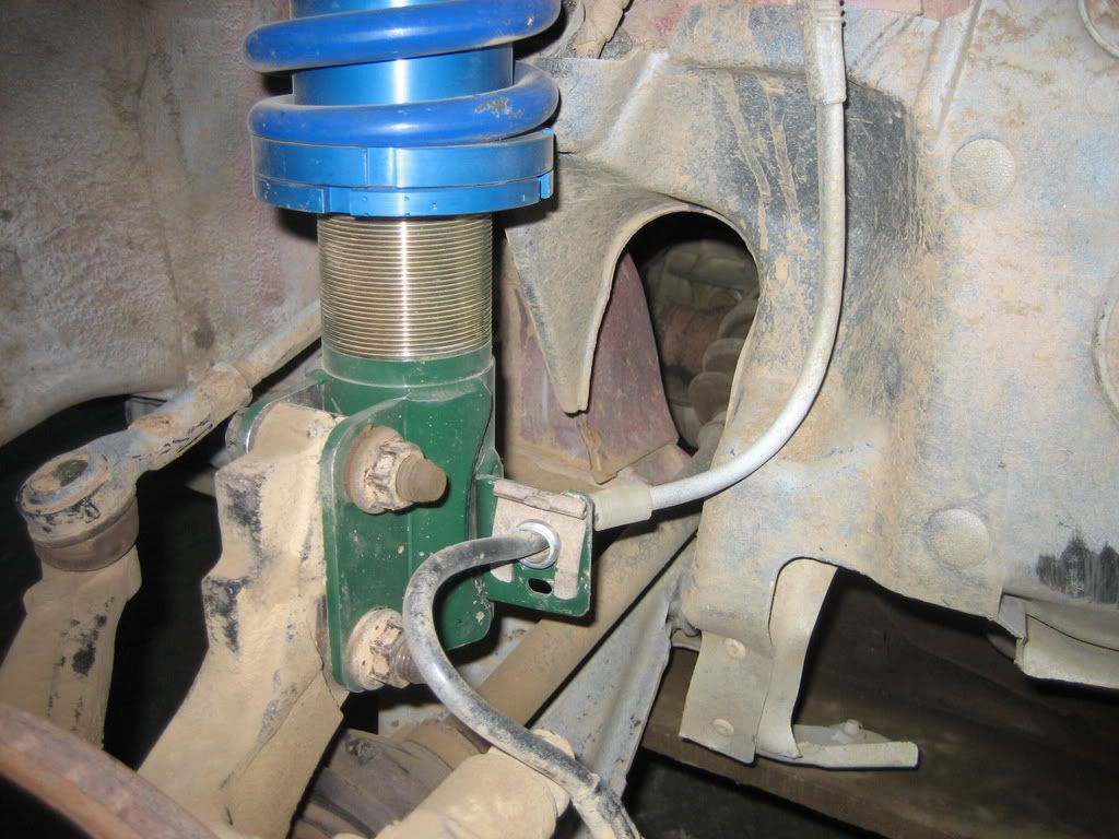

Here ya go John. I finally got around to making some ears and assembling the strut tubes and inserts that I bought from you last year. Couldn't bring myself to paint them "nuclear florescent JVAB booger green" though...I compromised with a random can of dark green from the paint cabinet I cut the brake hose tabs of a set of stock struts to make it a clean bolt in affair. The fronts are an extra 10mm of stroke at 185mm and the rears are stock at 210mm.
FRONT:
REAR:
The stock rear struts are so absurdly long that even with 210mm inserts I still had to add another 2" of extension to the tubes before they were long enough.
So far they are a vast improvement over the GAB set that came with the car. The spring rated are much more even front to back resulting in less understeer. I haven't played with them at full speed yet but they seem to just get smoother the faster I go... Way fun.

Looks good. Well done on the ears but they need gussets.
Re: JVAB GTX Strut Pictures
August 11, 2008 06:02PM
Thanks, I ran out of time on the gussets. I knocked off work at 4PM on Friday afternoon and by the time I had made the ears, machined the extensions, transplanted the brake tabs, welded everything up, etc, etc, and installed it was 1AM.
Then I took Al (thanks again for the help) for a little test drive on the railroad tracks behind the shop. I had some pucker when a big road bed rock came around in the rim and ripped off a rear brake line. We were going about 45mph and pointed strait at the RR crossing pole when the brake pedal went to the floor I scrubbed the tires on the rail and e-braked to a stop before we hit though. The new brake setup is going to get dual master cylinders...pedal to the floor at speed is not something I want to repeat.
