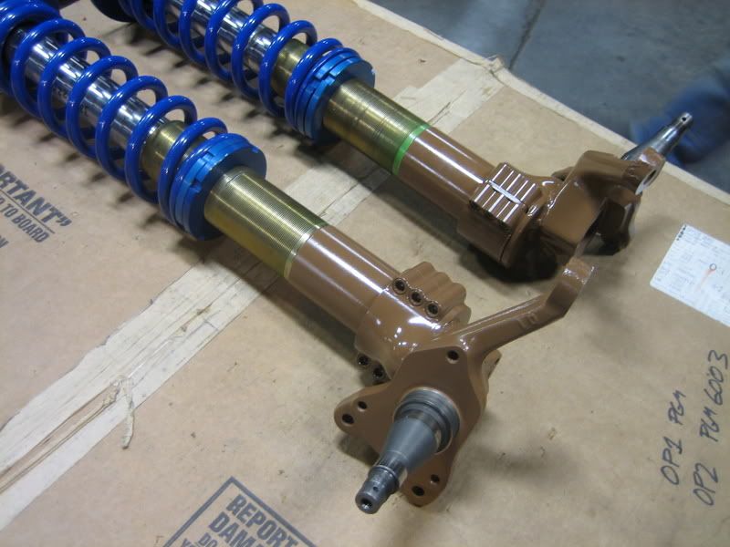

How does the coilover tube attach to the extention tube with the mount on it??
How does it go from this picture of the way you had it to what it is now?
Also how come this set that JV made for gtx a while back (2nd pic) not need the extra extension piece like your does? Are the struts longer?
open | download - bilstein tim taylor.jpg (189.4 KB)
open | download - Mazda01.jpg (65.7 KB)
Re: JVAB GTX Strut Pictures
August 20, 2008 10:06AM
I machined a locating shoulder into the JVAB strut tube and then a mating collar/weld v-grove into the extension. Tapped it together with a hammer and welded.
By designing the ears, making the ears, and installing them. I bought raw tubes from John because I wanted to make my own mounting parts.

Well they did get an extension. I make the tubes one length and for those Japonaise cars that got extra long tubes and long inserts, I make a short extension and it's under the ears thingies.
See the problem is welding in the bottom piece that the shaft threads into when it stops UP inside the tube.
There ARE Bilstein inserts with 210 travel and simply longer tubes but fawk me if I can find the PN and then they would be finished on the top end with some whacked out thread meaning re-doing that to fit the typical 15mm bearing the Japonaise use in their top mounts.
The extension tube is easiest and does just fine with the ears supporting it.

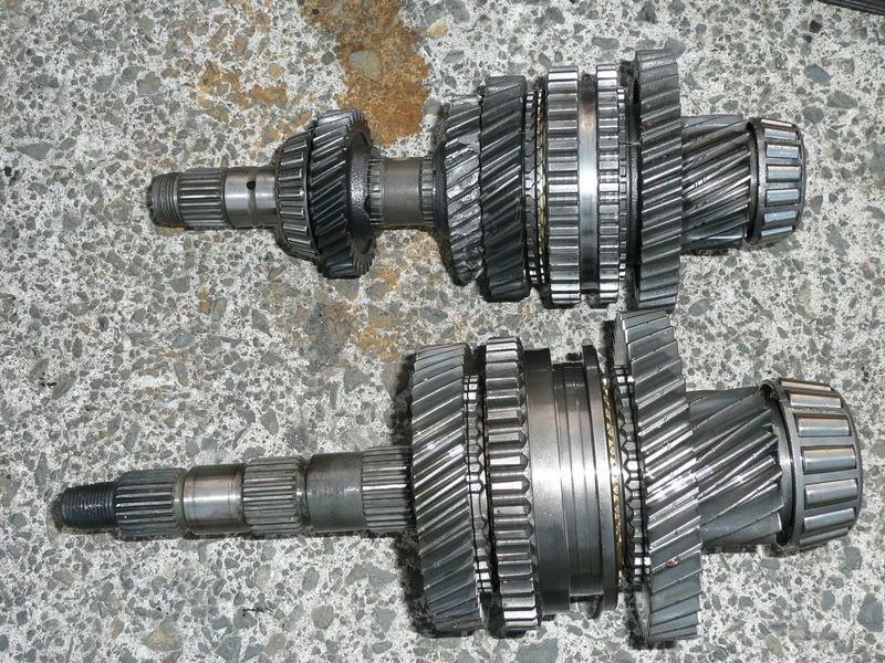

Yes I've seen it, but I don't really like it. The support plate is just a band-aid fix and the transfer gears are still weak. The Toyota transmission is stronger in every way including having, bigger gears, bearings, and better synchros. I'm going for minimum maintenance and no worries on the new drivetrain.
EDIT: Mazda BF on the top (note the stripped 3rd gear) vs ST185 Celica on the bottom.
