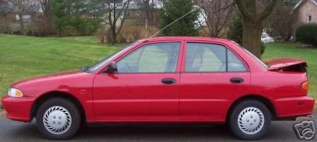

I would like to share my project with you guys over at Rally Anarchy where it will be appreciated. Before I bought this car I searched for months on end to find the perfect shell for this project I had in mind, I found this 95 Mitsubishi Mirage on ebay where it was listed 3 times and each time the buyers backed out. It must have been waiting for me. I drove down to Ohio to pick up the cleanest car I have ever seen. For a little information about this car, This car is originally from Arkansas and spent very little of its life in Ohio before I bought it for 400.00 with 199,000 on the odm.
Here is a photo from the Ebay add.

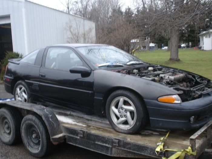

This here is the photo of the parts car 6/4bolt 4G63, I ended up using none of the parts off this car and sold my half to Dexter.
Zach and I messing with something, thats also my Sebring to the left
Money shot

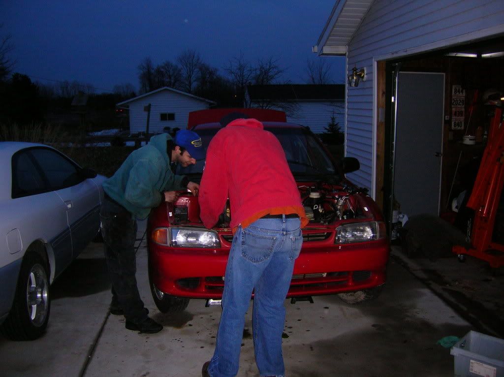

Thats me next to my truck, on the way down to pick up the Mirage, Dexter's DSM tagged along, because afterwards he was heading to Chicago and I was heading back home with the Mirage

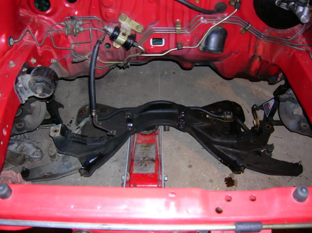

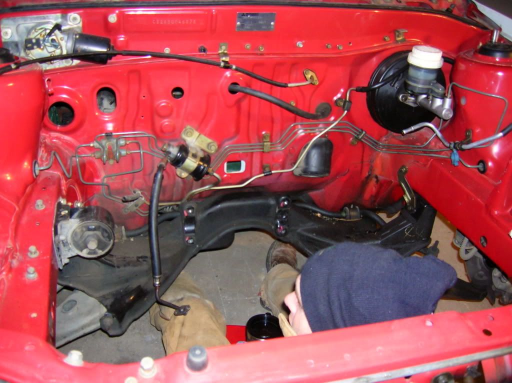

The camera's batteries went dead so you missed out on watching the engine come out. More photos will come tomorrow of the empty engine bay.

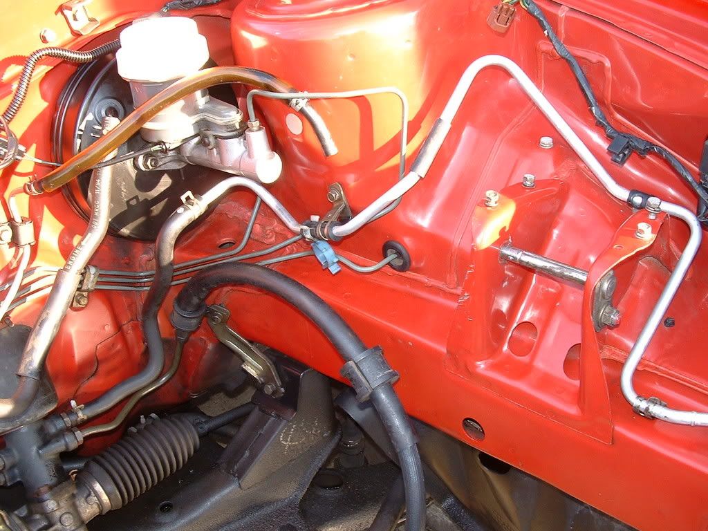

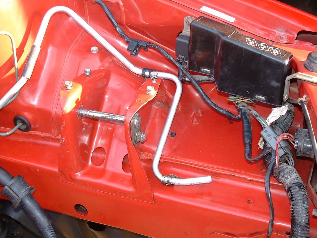

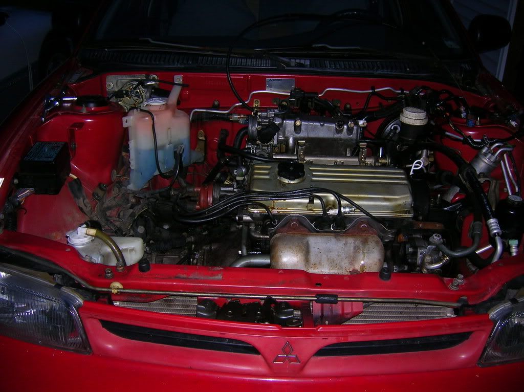

I cleaned up the engine bay a little its still pretty dirty yet, here is some more pictures for you all.

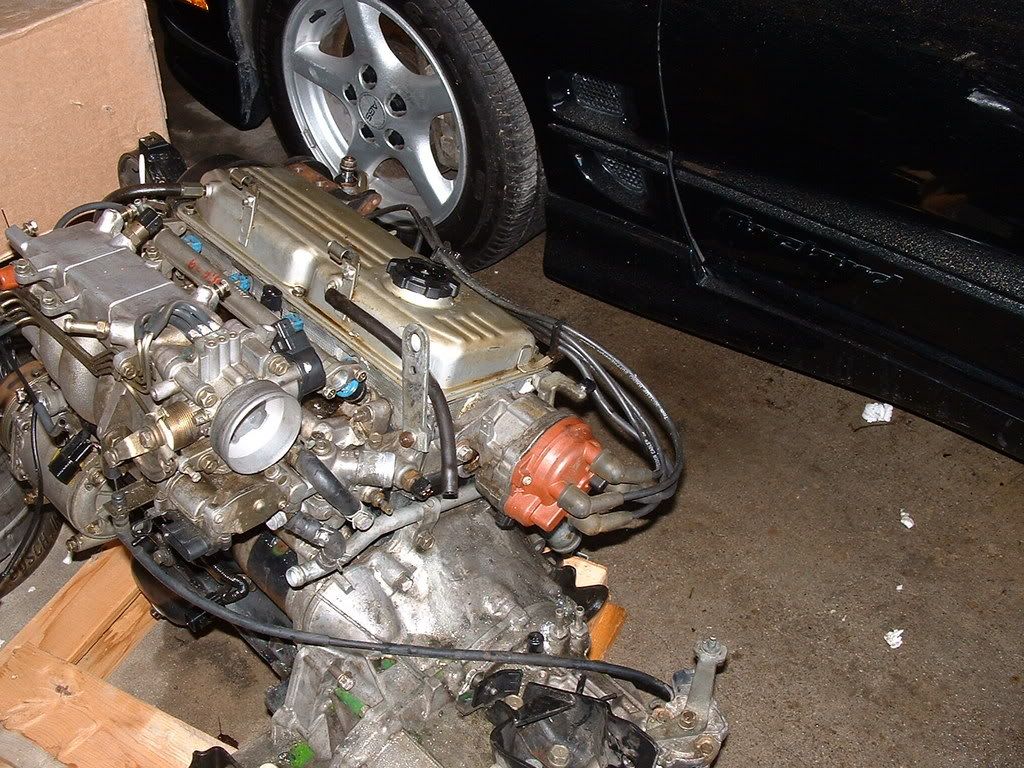

And the old 4G15

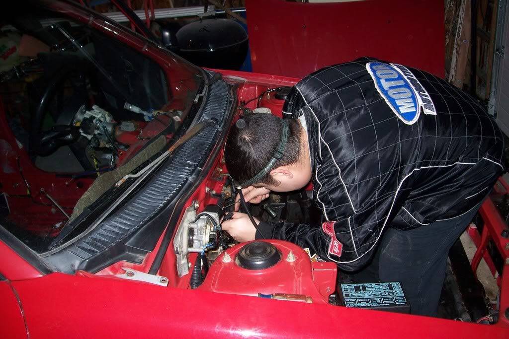

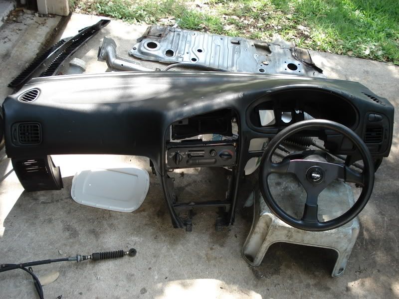

Dexter working on pulling the dash.
Me giving the bull horns, while removing the rear speakers.
Backseatless

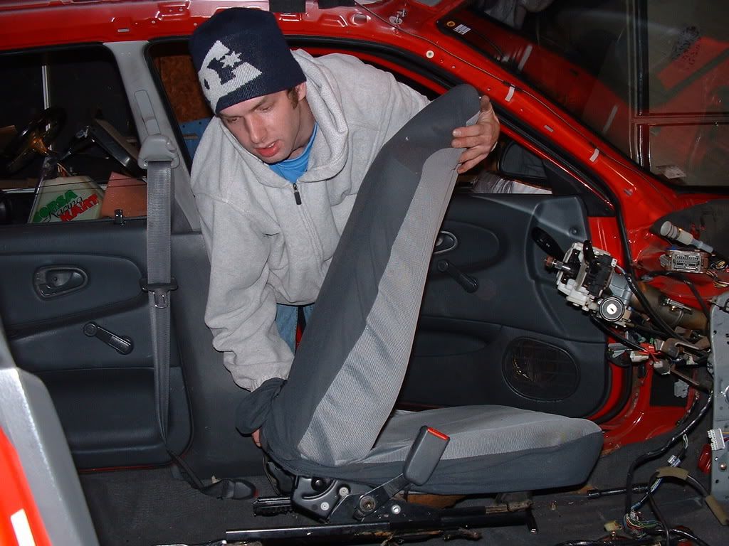

This is me pulling the old seat.

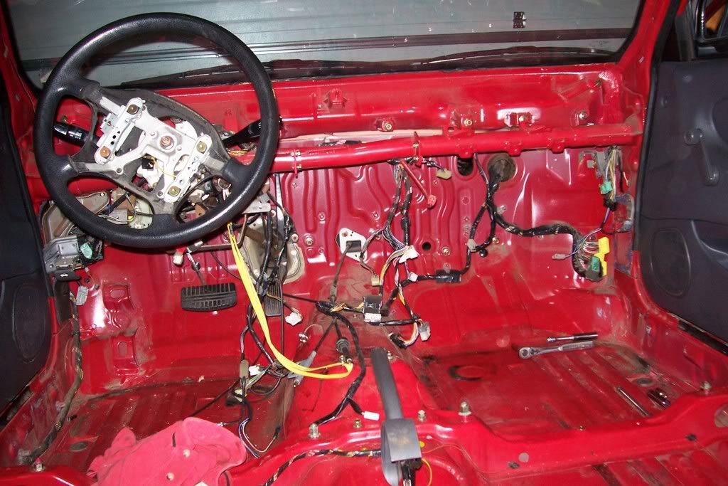

Last night we removed the rest of the dash and engine harness, removed the gas tank, and pulled the heater and AC out. So far total time is 37 hours.
If you look closely you will see me under the car, getting ready to remove the gas tank.
Fady is pulling the hoses for the heater core.
Gas tank removed, looking frontward.
This is after Dexter removed the AC, Heater Core, and Blower fan.
Engine harness removed.

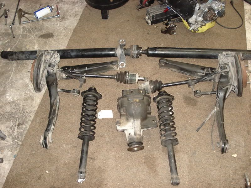

I'am going saturday to TRE to get a Evo3 gear set for it. My rear diff is a Evo 3 RS "Cluch packs" FTW. I never ended up making it out to TRE.

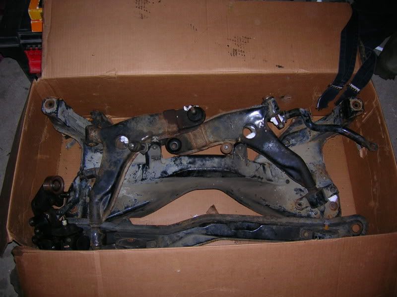

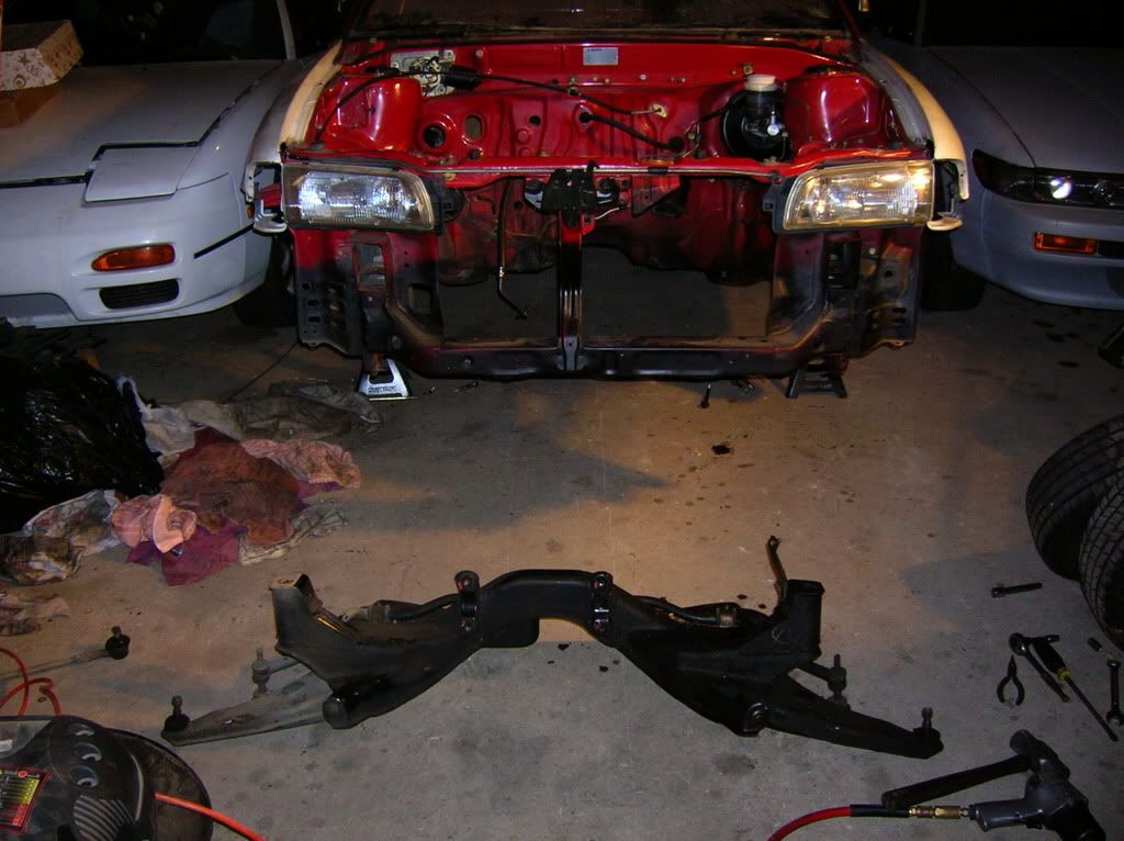

K-Member, cross member, Evo control arms, and sway bar.
Thanks TKR
Last weekend I removed the old K-member, Lower control arms, and Power Steering Rack.
Out with the Old in with the new, wait a min. What happen to the pics? Oh yeah the camera was dead.
So Thursday night Dexter and I fit the Evo K-member and cross member  in to place.

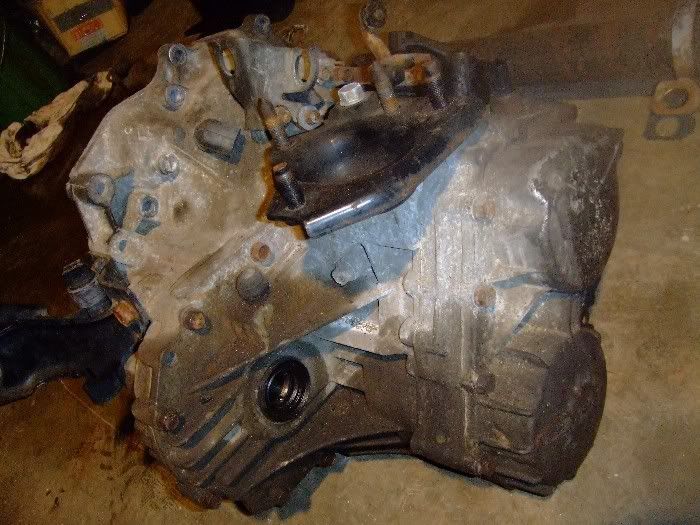

Last night Dexter, Fady, Zach, and I started to drop in the 4G63 Dummy block mated with the 2Ga DSM tranny. We used the Evo timing belt side motor mounts, The rear Auto mount off of the 4G15 tranny on the front of the  2Ga tranny, The mount on the tranny is off a 1G dsm.
I know that there is a difference between the auto and manual upper transmission anchor mount. Right now the right hand side is sitting back about a 1/4th - 1/8th inch.

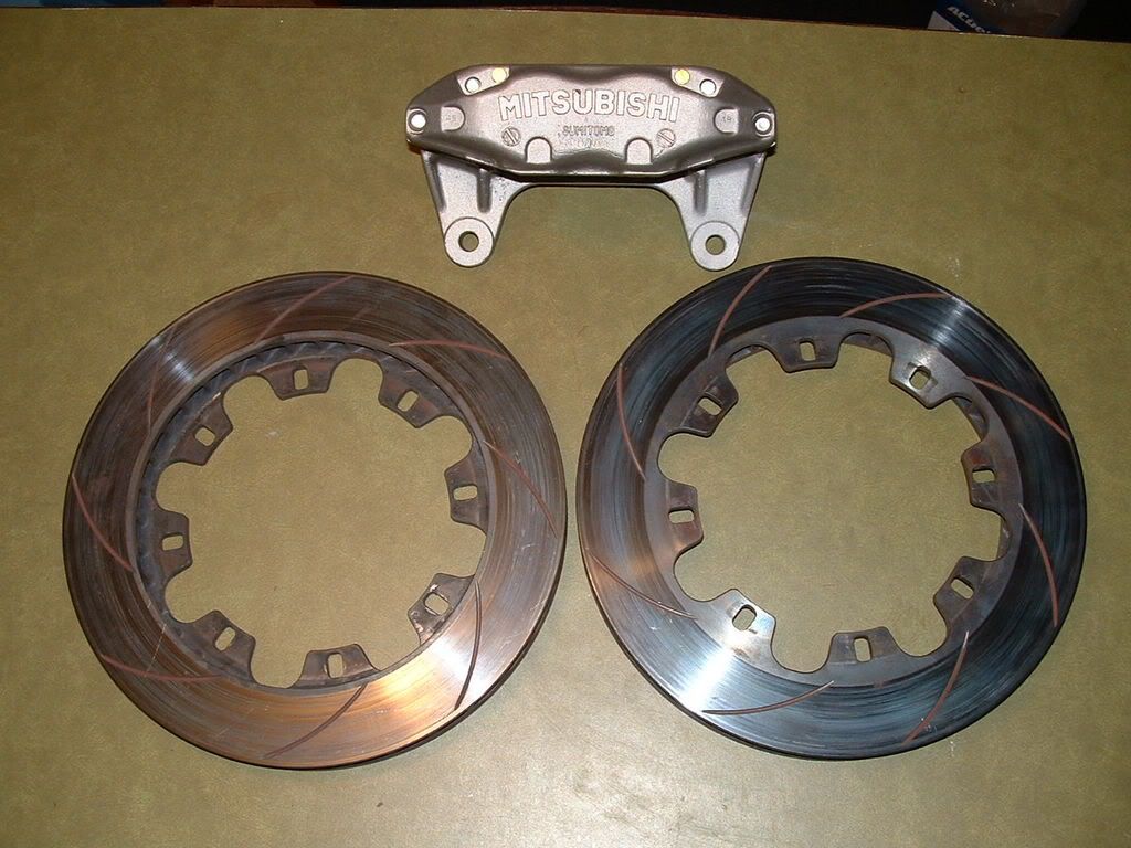

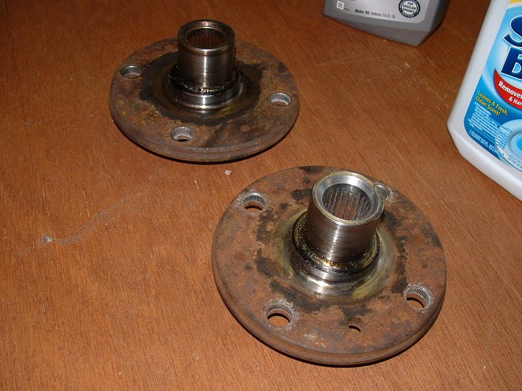

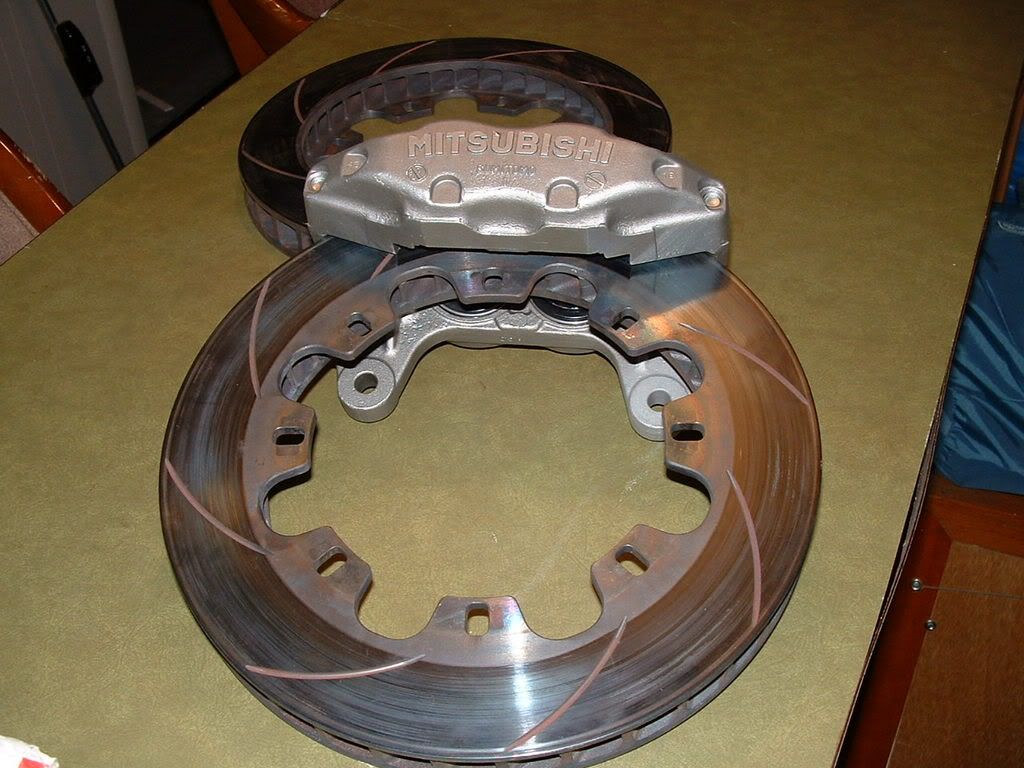

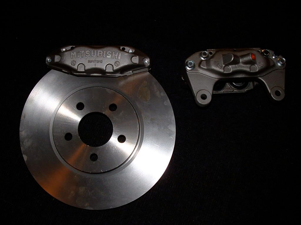

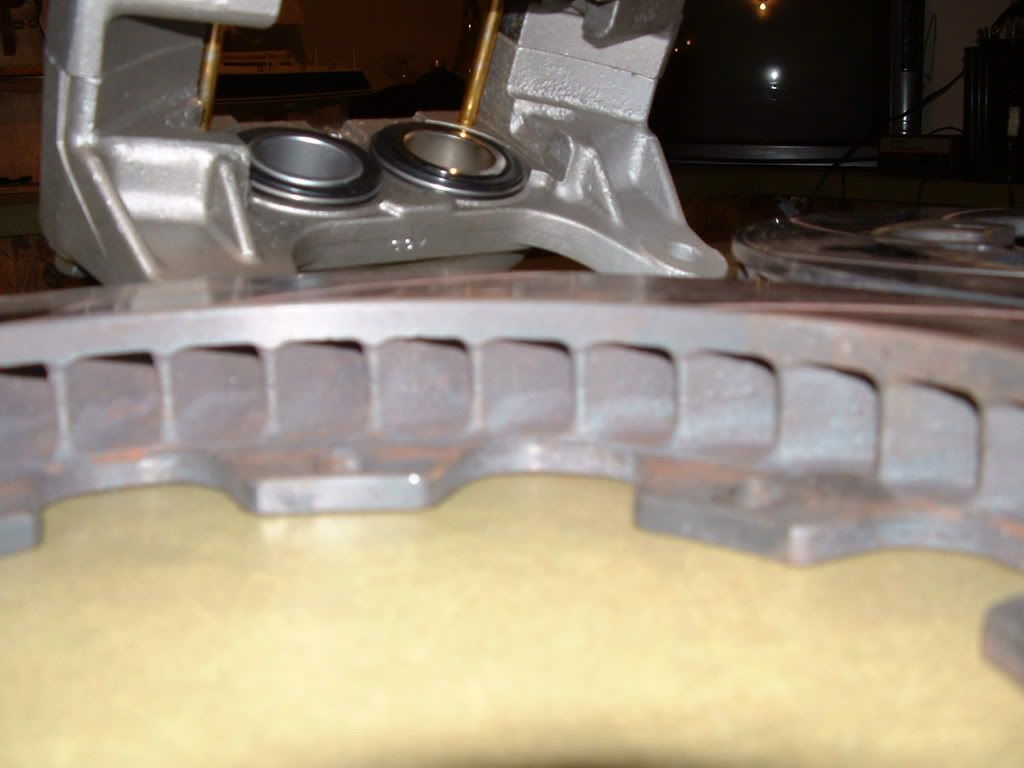

I received my AP 309mm x 32mm rotors today.
Once I finish my 4 x 114.3mm hubs We can start drawing up our rotor hats and brackets.

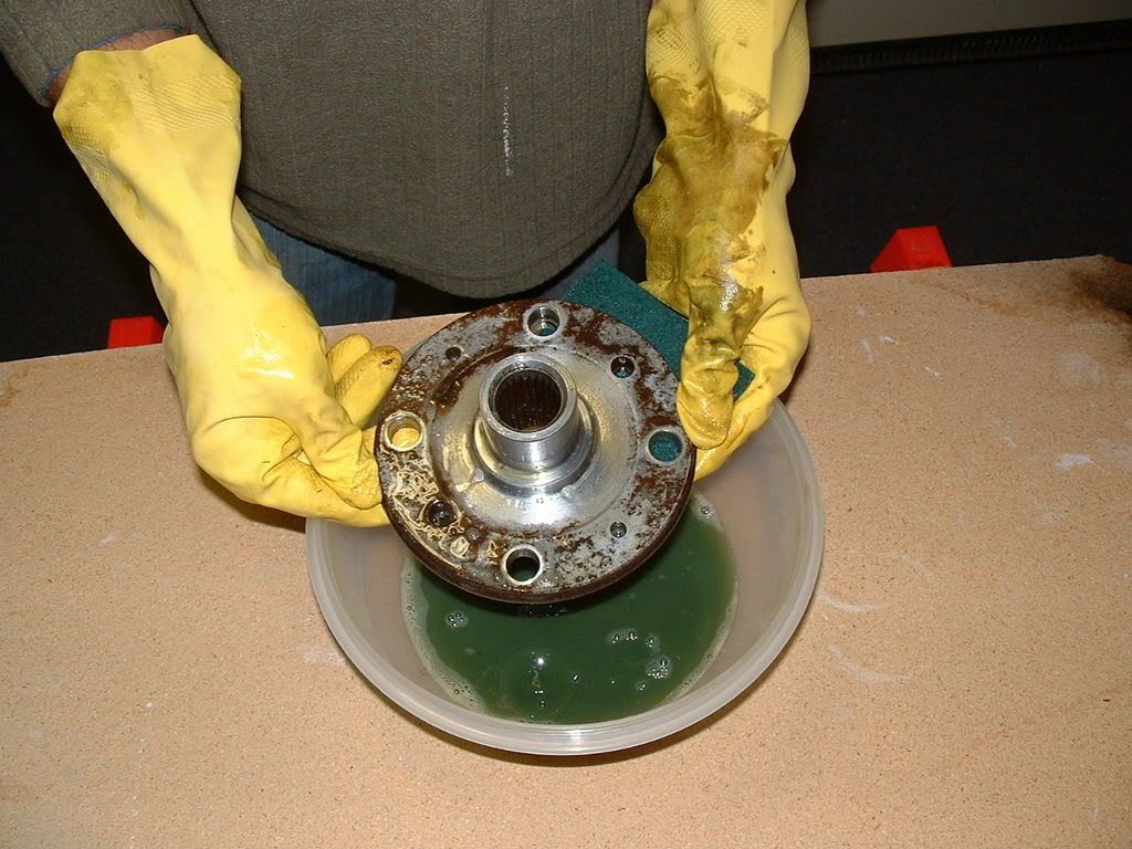

So tonight I did a little chemistry. But your going to have to wait for the full write up before you even want to attempt this.
I couldent wait to show you what was going on.

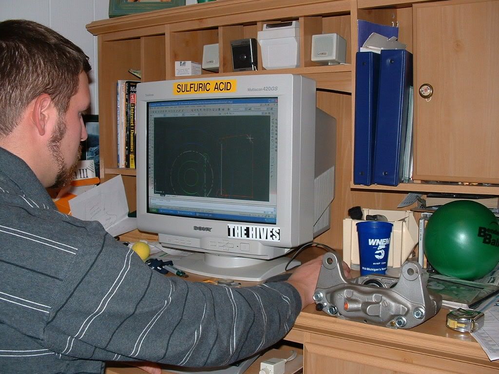

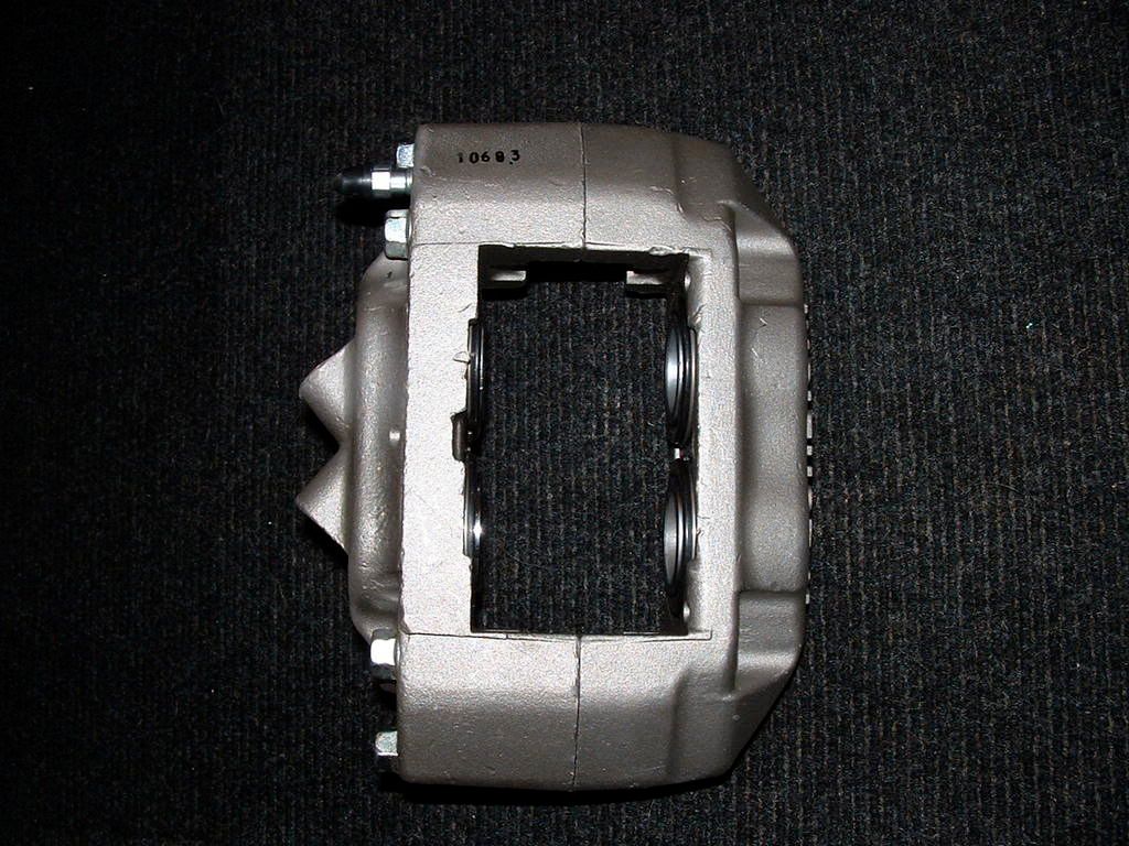

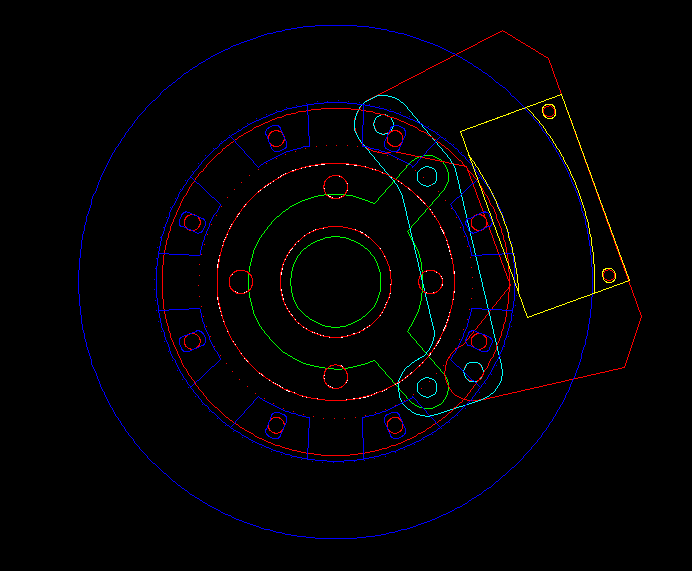

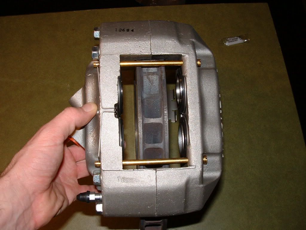

Dexter is the man when it comes to autocad, Here he is hard at work

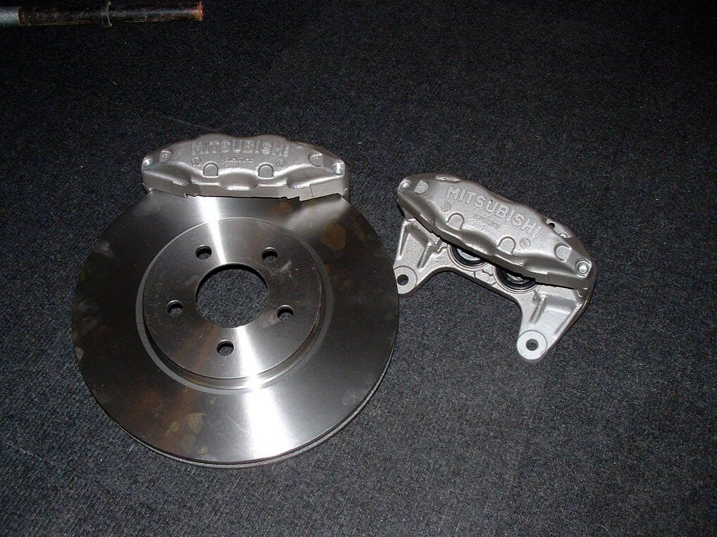

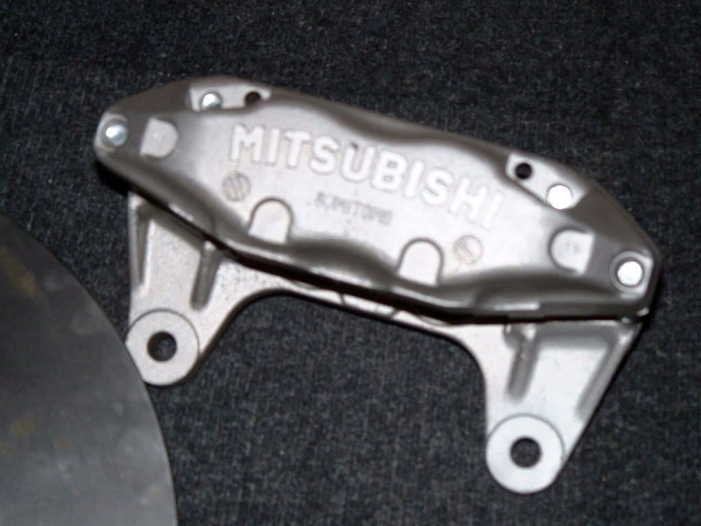

We are designing a brake kit so I can run monster rotors and 3kGT VR4 calipers on the Evolution Project.
Here's the caliper adapter we just designed. This is so I can use the  calipers on my Evo3 RS project with the rotors I have and Dexter can use them on his DSM. It's going to need some fine tuning and We''ll probably do some stress calculations to ensure it can perform like we need it to.
Then we designed the rotor hat so we can stick the monster rotor to the summit hub that I have decided to use. Dexter's hat will be slightly different since it has a 5-bolt pattern instead of 4-bolt. Again, needs some fine tuning to get the offsets and thicknesses right so everything will fit and line up.
Here's a shot of the entire assembly:
After getting all of the bugs worked out with the fronts here, we need to figure out how to make these work in the rear too. Stay tuned.

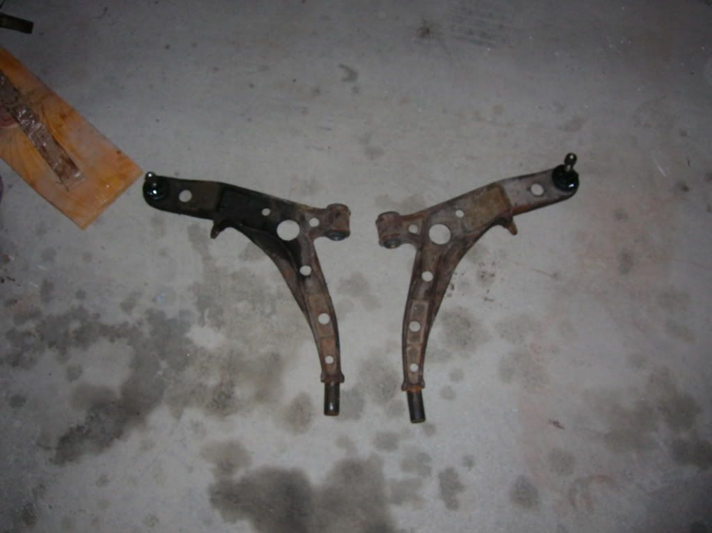

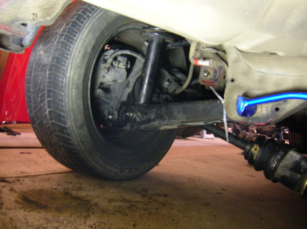

Expo Front lower control arms very close to Evo3 as your going to get, Currently they are in the clean up stage waiting for nylon bushings

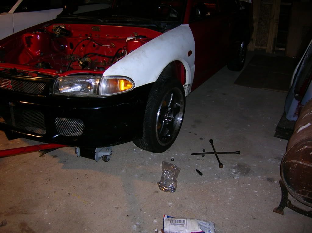

After we fitted the Evo trailing arms I decided I wanted to try some of Dexter's wheels on for shits and giggles.
Test fitting the Cusco Rear lower Tie bar. You can also see some Evo trailing arms.

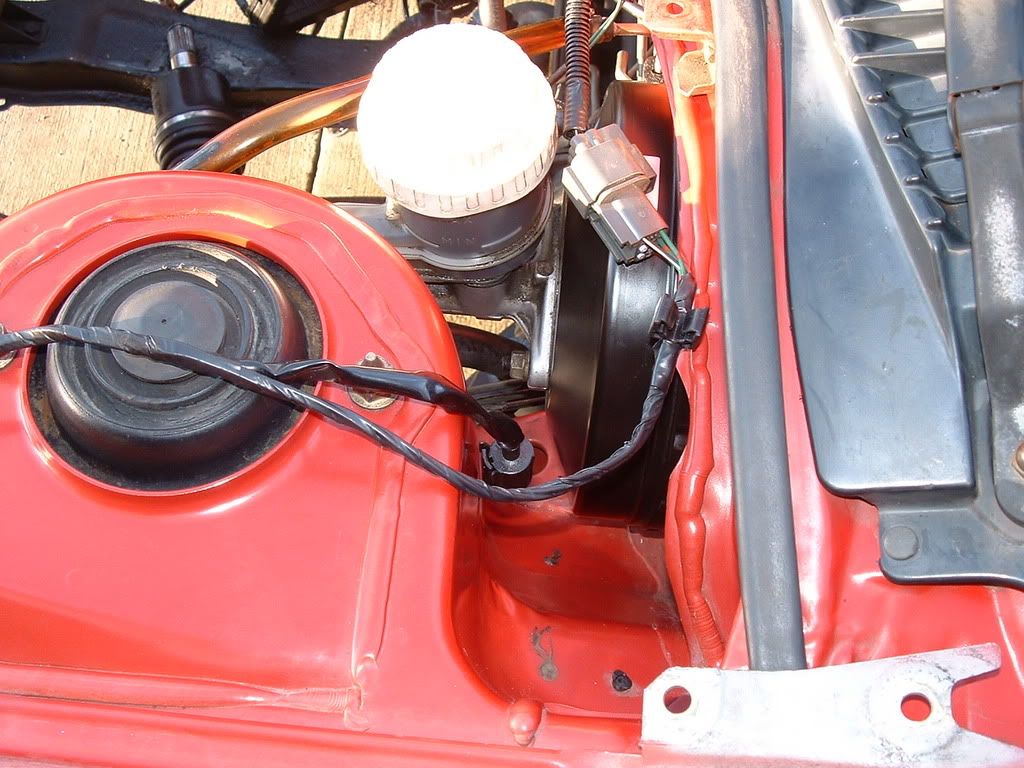

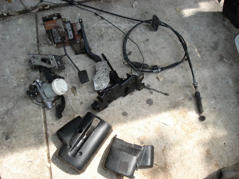

I will try to get a better picture of my new pedals. They are a Wilwood dual Brake MC, Reverse Swinging setup

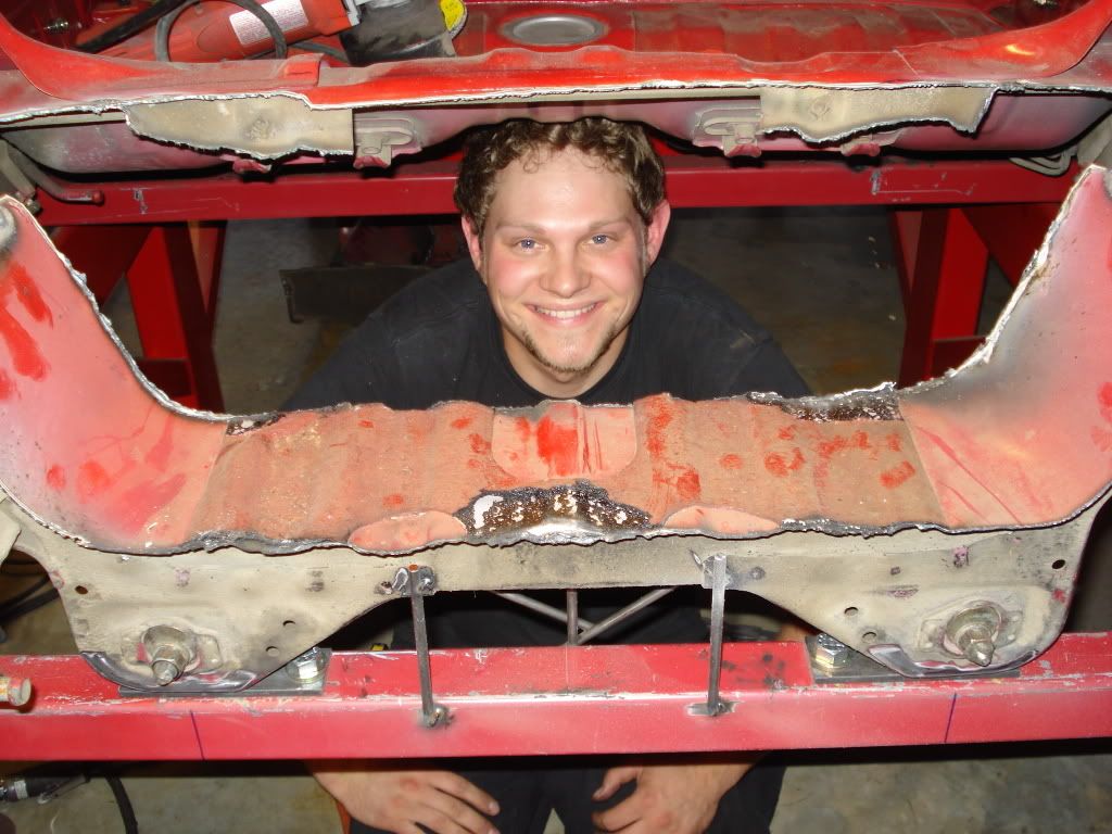

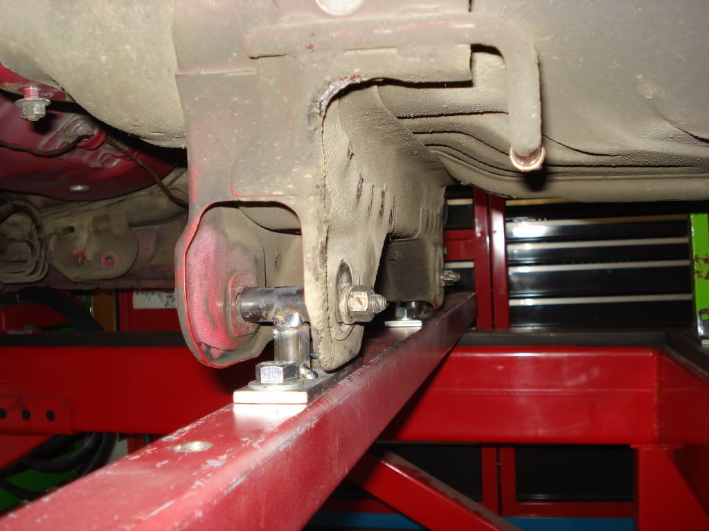

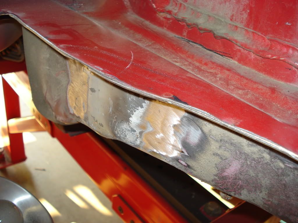

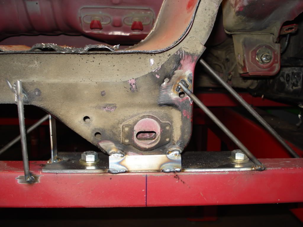

More updates, sobbed up the "Old" lower control arm mounting location.
This is my Buddy Josh saying hello.
More pictures, because everyone likes pictures. LOL
Lower control arm mounts stobed up
Same as above just up close
Lower control arm mounts to bolt up trailing arms
Same as above but just up close
There will be more progress tomorrow. Pics to follow...
Here are some photos of my car sitting on the chassis jig.

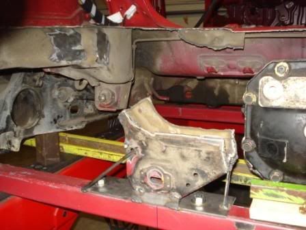

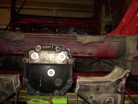

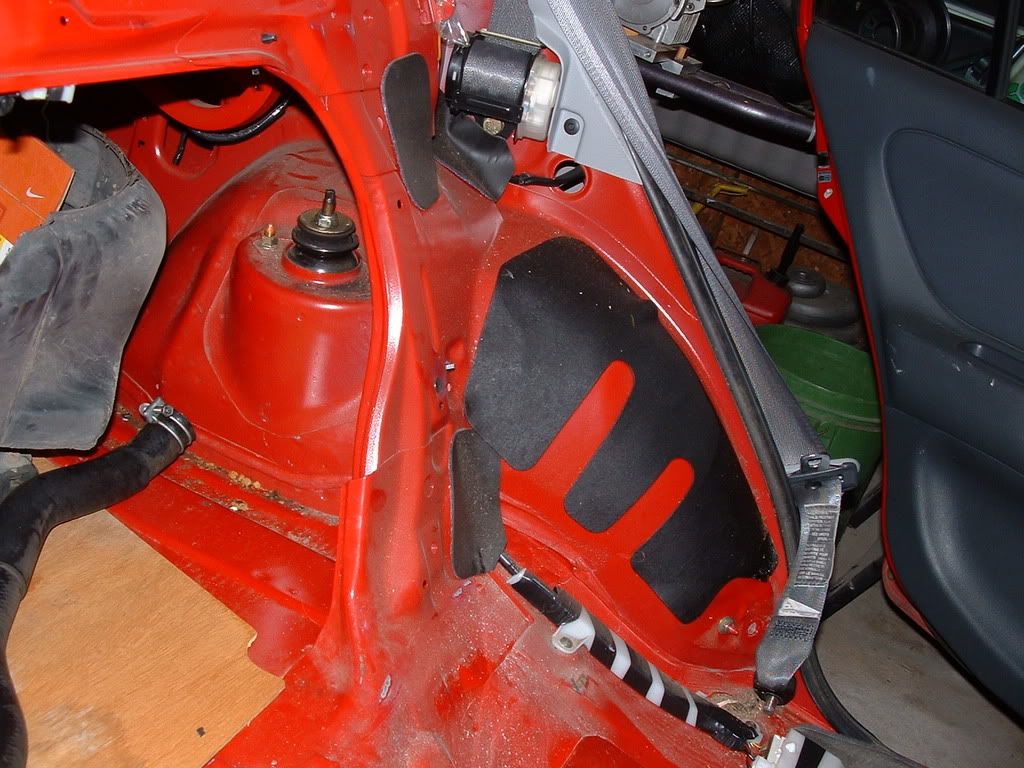

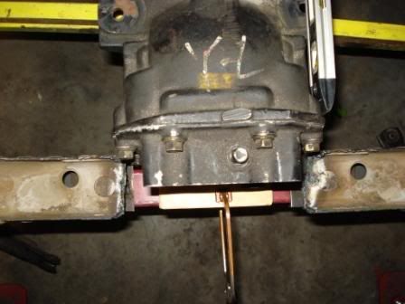

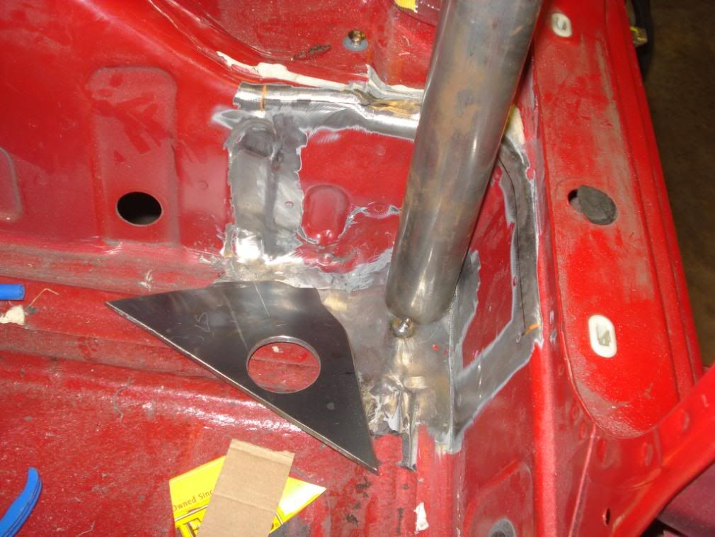

We are trying to figure out where we want to place the diff at right now. There is about a 2 inch difference between the output shafts for the front wheels to the output on the transfercase. I think we are going to center it between the two outputs.

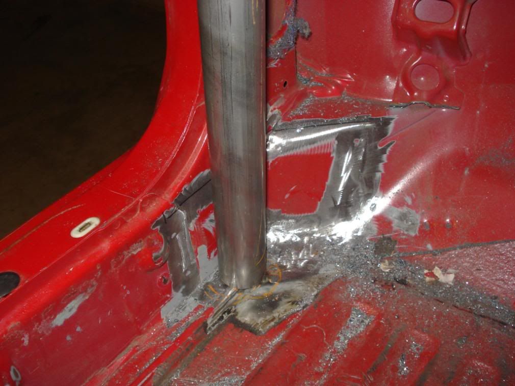

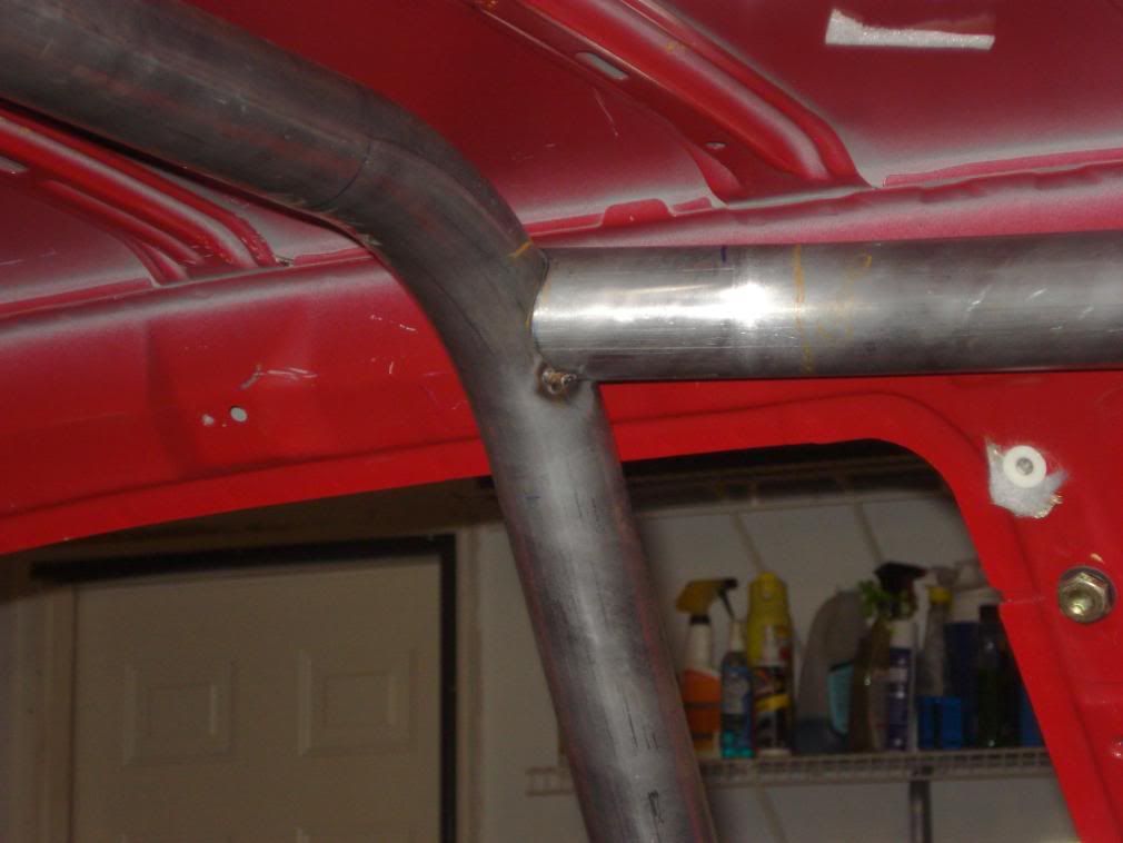

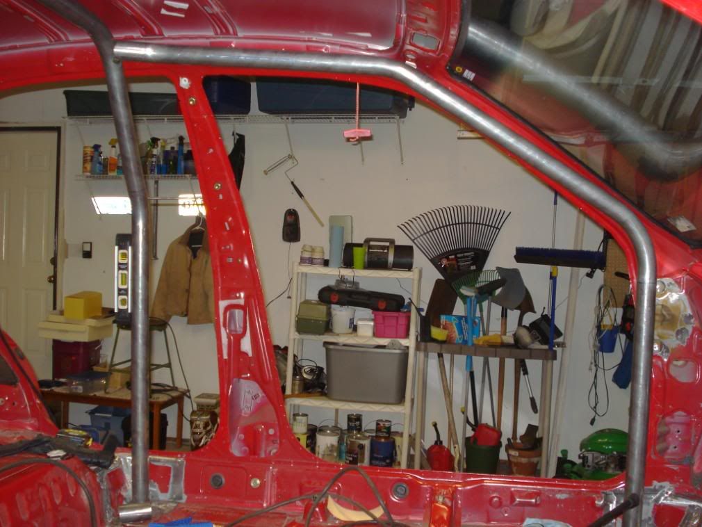

B-Piller Main Hoop.
B-Piller Main Hoop and A-Piller, Notice the dash bar is gone.
B-Piller, and A-Piller connection.
A-Piller
B-Piller and part of the boxing that is going to go around the post.
