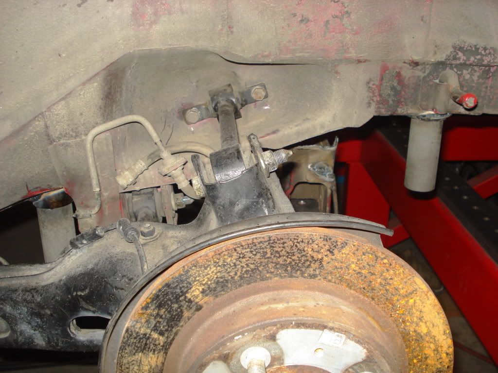

Front suspension is getting redone with Tubular steel, and Delrin bushings.
Rear suspension is getting spherical heim ends, We are still thinking of an idea to get rid of that big rubber dildo materiel of bushings on the trailing arms.
Eventually we are going to re-do the trailing arms.

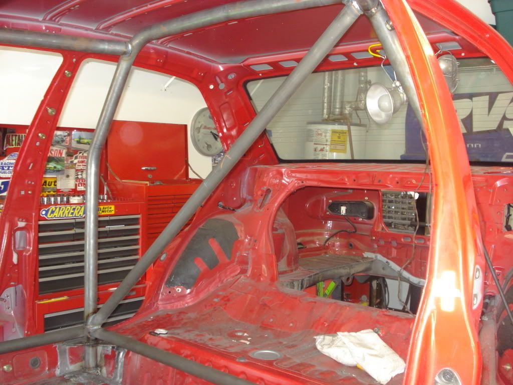

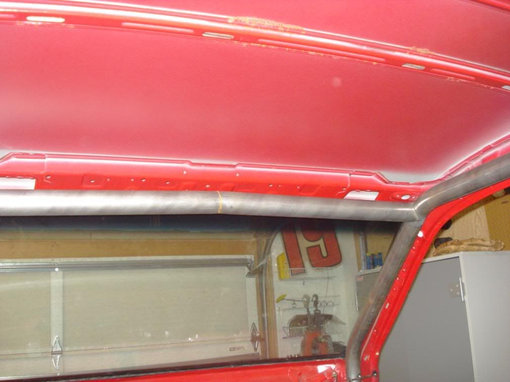

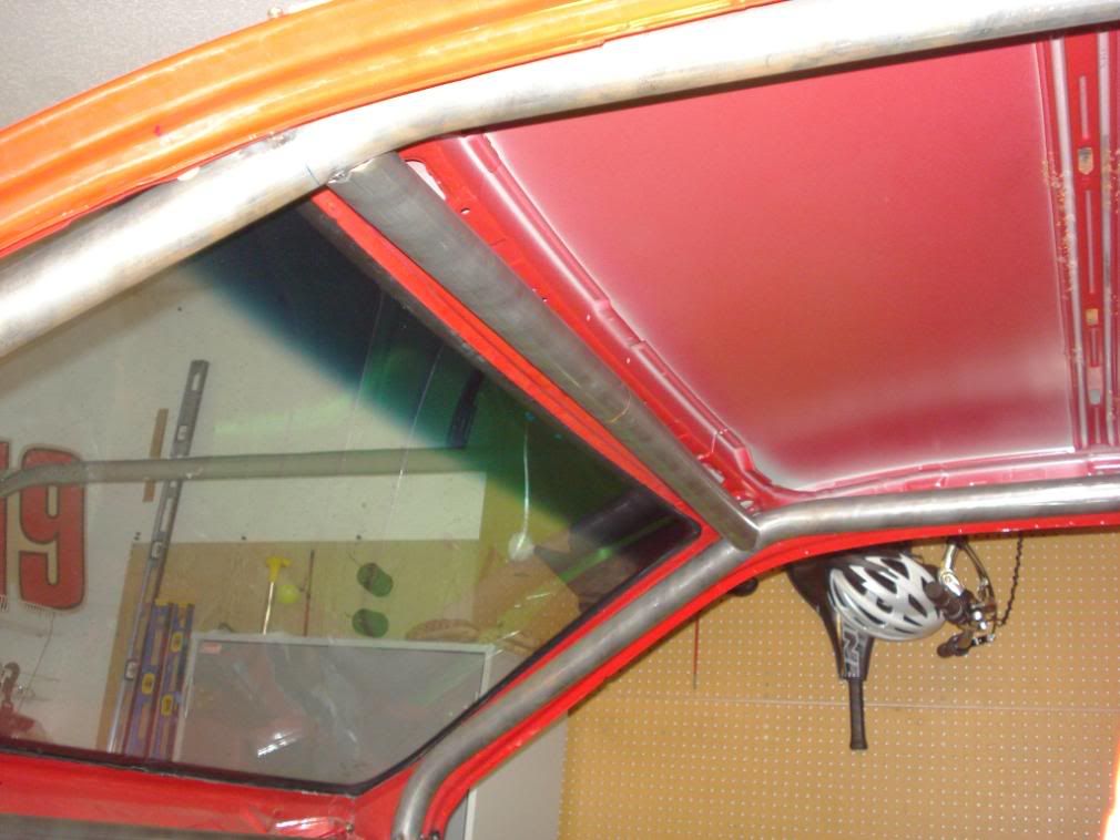

Lateral half-rollbar 253-3 and Upper front of wind screen bar
A-post and main hoop base welded to floor and jack stand tubes in. Mounting feet/Reinforcement feet, the main hoop box is 17 sq. in. top plate is 3/16 and the side is 1/16.

Lower main hoop bracing along with the still bar connection.
So far half of the X-brace configuration is in.
You can see the still bars are in along with the lower main hoop brace

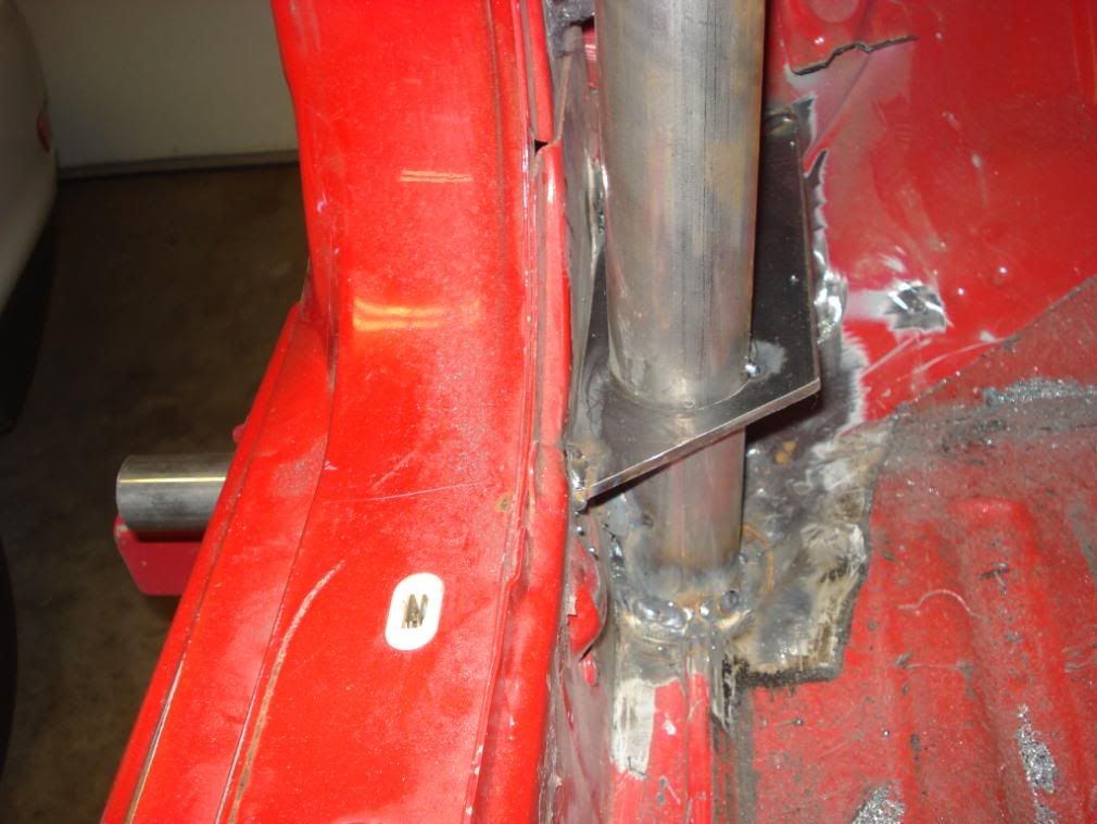

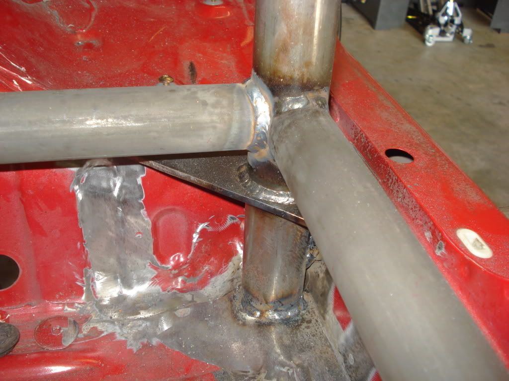

One of four rear sub frame mounts, the lower section you see bolts up to the tube that you see welded in place.
Rear bracing

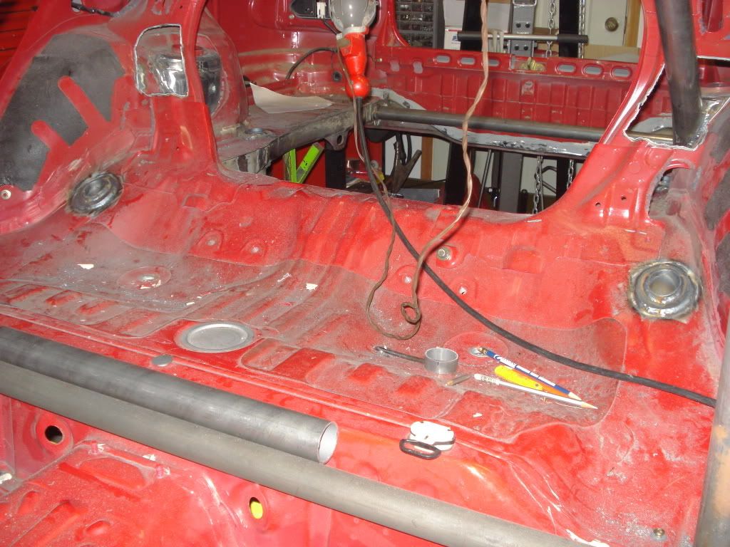

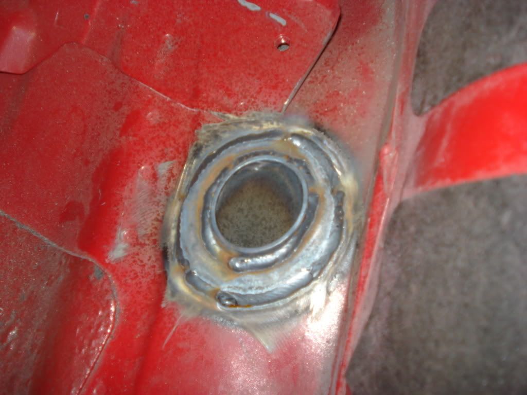

Update for tonight, Left side sub-frame mount pre weld.
Post weld
Here you can see the Left side back stay, and all four of the sub-frame mounts. We ran out of tubing on tuesday, we ordered
Three more 20 foot sicks of 1.5 x .095 wall and one more stick of 1.75 x .095 and a sheet of 4ft.x8ft. 20gauge sheet metal.
In this picture you can see the tubes that are going to be part of the sub-frame, They slide up in to the car and bolt in with a 12mm x 1.25pitch bolt

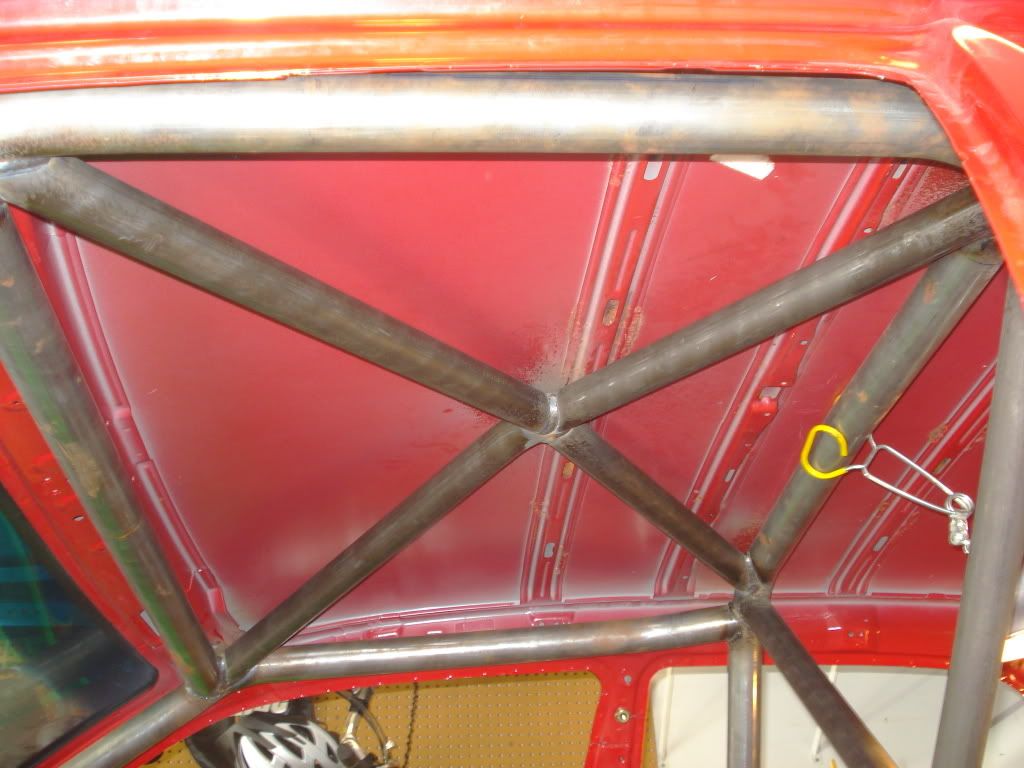

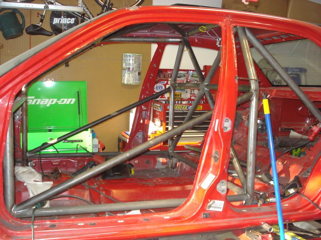

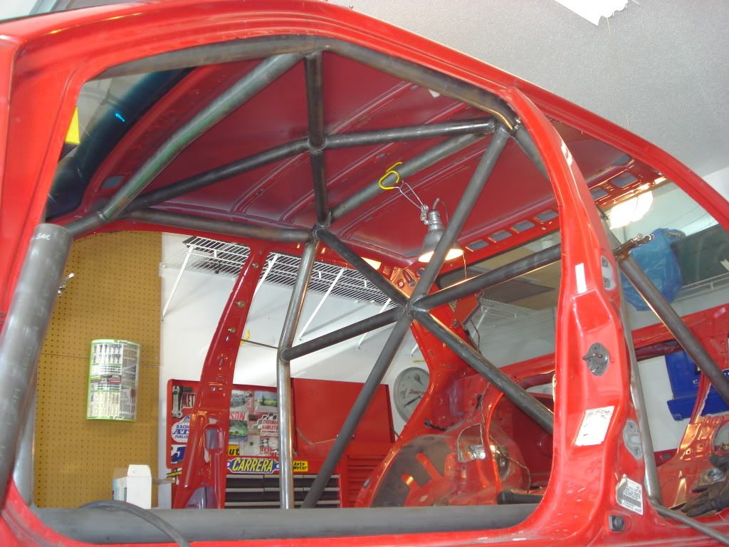

More updates on the roll cage today, today we were able to get 8 bars placed and welded in.
Completed the X in main hoop.
And and then with shoulder harness bars in place, the harness bar is 24 inches from the boxes.
Picture of the top hoop X.
Another picture of the top hoop X from a different angle.
Half of the door bars are in.
We plan on getting another 8-9 bars i tomorrow, hopefully we can get the rear back stays finished off.
