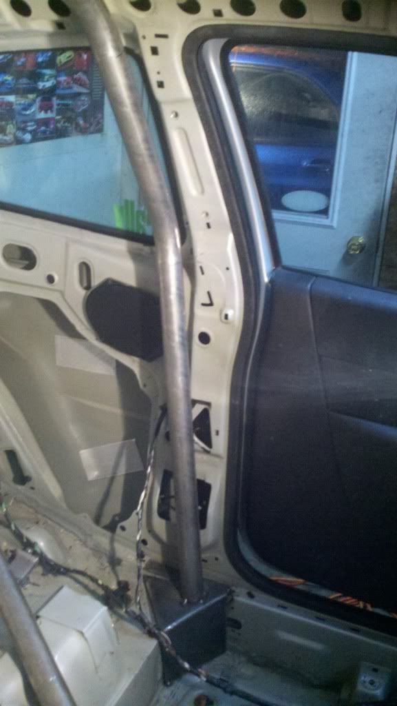

I used bend tech pro today how freeking awesome! hoop and front legs fitting the first time rock on!!!

Are you planning on replacing the dash bar with part of your cage? Looks like your covering up the bolts for the dash bar with that half lateral.
Out of curiosity why are you doing the cage now before the suspension / drive train fab is complete? I would think the cage would just get in the way of that work.

the bolts are gone and the dash is cut. I'm going to mount the dash to the cage.
4 legs wont get in the way of anything. buying time for my 930 stuff too show up
and time to build the rear knuckles, my hubs came in last night.

That looks great William! That bend tech program looks like it makes things much easier.
Re: RSF2000 Rally Sport Focus! RWD Revolution
February 18, 2012 12:25PM
omg sean Its epic I was with in 2 deegrees of perfect each time.
just needs some more calibration and little more playing with on
my part. but talk about saving tube. When you cut your hoop your
like no way this is way too small and it fits perfect.
