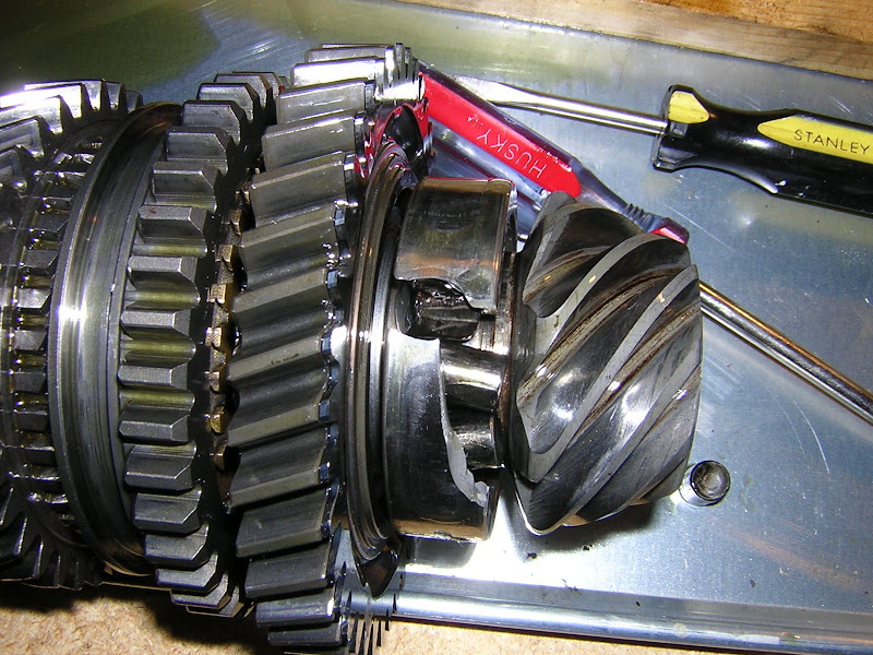

Don't fuck it up. Even Subaru gets it wrong. This is what happens when you (or Subaru) doesn't set the backlash properly on the front diff bearings:
The bearings that fell out of the main bearing assembly were D shaped instead of O shaped when looking along the length of them!
Tranny lasted 1.5 miles! smiling smiley
