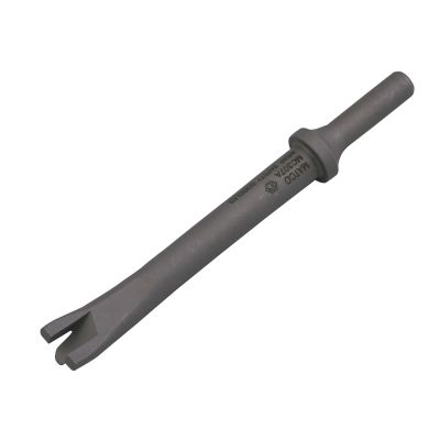

Re: i need some motivation
June 22, 2011 08:03AM
If you have an air hammer, these little nibbler attachments work good for cutting sheet metal:
Its called a "sheet metal trimmer chisel".
Heres one for $5:
http://www.toolrage.com/prodview.asp?sku=ATD-5702
No sparks, no high rpm cutting disks, no dripping molten metal, and no slag to grind off after.
I've also gotten a remarkable amount of life out of my $10 harbor freight die grinder. I have probably over 50 hours of use on it and its still going strong. The body saw, on the other hand, is one of those harbor freight items that falls apart right away.
Edited 1 time(s). Last edit at 06/22/2011 08:04AM by Carl S.

dont have an air hammer yet. how much does that chisel deform the metal?
June 22, 2011 09:09AM
It doesn't deform it noticeably from my experience. I'm sure if it got dull or you tried to go too quickly you could muck things up, but they're reasonably idiot proof. You would still probably need a cutoff tool of some sort for seams and creases and tight areas.
