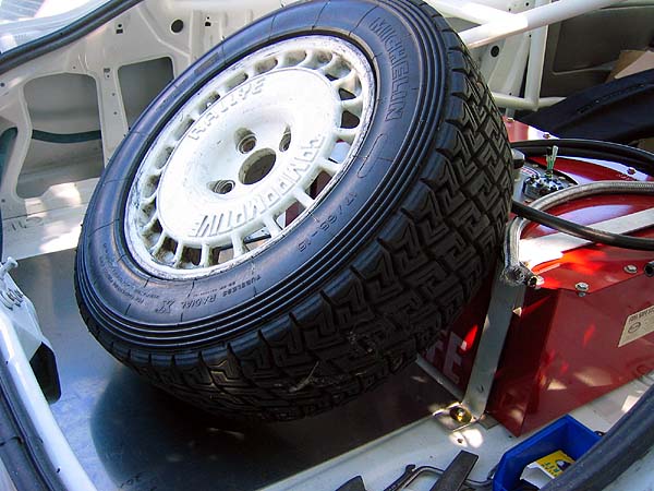

Yeah, here's what we did one Skye's and Scotts cars and it works in the whole rest of the fuckin world, except Rally America:
Pump details:
Mounted on a plate isoltated using Misterbitchy Eclipse wiper motor mounts.
Then you make a alloy cover and secure the tire in this position (make a wedge shaped alloy trough thing for the wheel to sit onsmiling smiley

Well the point is, the Fuel Safe cell is *already* a metal box around a foam-filled rubber bag - why does the metal box need a metal box around it? How about a metal box around that? It can be like a Russian nesting doll set. That factory Ford Sierra setup is the same damn thing, a metal box around a bag.
Hence the references to the helmet protector-protector...
The regulation is probably the same but the current interpretation is brain-dead.

In the pictures that John posted, wouldn't an cover that seals the filler tube(to the body exterior where the filler cap would be) and seals the open oval in the top of the cell container be legal?

Martin's arrangement is pretty much what I was planning on doing. You're getting a CARS logbook anyways, put the thing at the codriver's feet!
