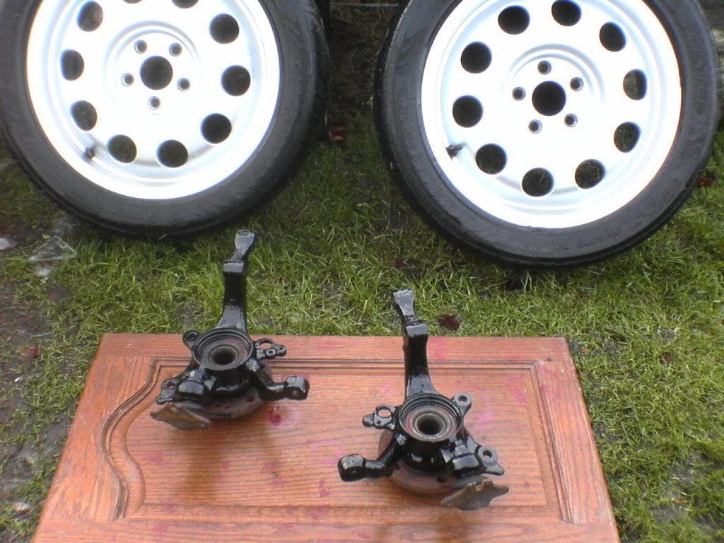

Assortment of mk3 Golf VR6 / GTI or Corrado VR6 components.
Uprights showing different balljoint position.
The brakes on the above conversion are either 280mm or 288mmm and will require the use of 15" wheels and of course the 5 x 100mm PCD stud pattern.

Slight lingo problem here....knuckles = uprights? Or knuckles = bottom balljoint?
Either way they are both different. If you look closely at the pic you can see the bottom balljoint is a taper pin on the 5 stud upright rather than the pinch bolt you have on the mk2 / 3 Golf 4 stud uprights.
You can also see the balljoint is set slightly forwad on the casting which gives the extra castor on this setup.
The 3 bolts that hold the balljoint to the wishbone are also slightly different in their postions. But the main issue will be that if you try to fit this upright to your existing 4 stud wishbones the wheel will not be centred in the wheel arch.
The wheel bearing ID / drive flange OD are the same as your 4 stud 256mm uprights though so I suppose you could fit the 5 stud drive flange and use the larger splined outer CV. Redrilling the drive flange to take your 4 x 100 disc and wheels.
Doing that would be a bit it messy IMO and you would not get the benefit of the wider track and better geometry.
The disc offsets are different too, the 280 and 288mm 5 stud discs being shallower. And unfortunately the mk4 Golf 5x100m 256mm disc is too deep an offset or it would have fitted and 14" wheels could have been used. Bespoke disc or spacer could solve that issue though as the 256mm caliper carriers bolt right up to the 5 stud upright.
Another thing to consider is that due to the design of the 5 stud VR6 uprights balljoint postion it means that when the steering is turned the driveshaft moves in and out more within the inner CV. So one needs to keep an eye on shaft plunge to ensure the inner CV does not kiss the drive flange and shatter. Limiting steering lock on the rack with spacers helps with this.

That pic with the wheels is just to show the "knuckles", it was taken when I was converting my Corrado road car from 4 stud to 5 stud. The wheels in the background are Audi "pepperpot" 15" 5 x 100 to go on the road car.
