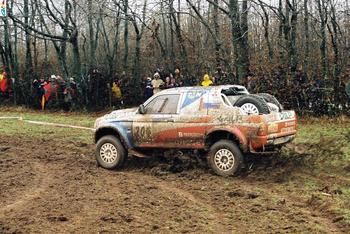

who said trucks aren't for racing ?

i do lean more to the suv side
I would rather drive a slow car fast as a fast car slow!
first rule of cars: get what makes you happy, your the one paying for it!

Nice Suzuki! I have an SX4 Crossover, and it's a pretty fun car to toss around. I did a couple of rallycrosses with it, and it was a blast.
