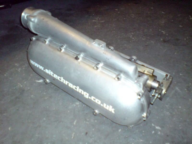

I've seen people talking about dual plenum intake manifolds for the diesel VW's.
I have no experience with them but it seems like every turbo rally car has one and other low revving boosted stuff like the Audi R8 Le Mans:
Skoda Fabia WRC
EVO WRC:
206 WRC:
Audi S1 Group B:
Cosworth EVO X:
Cosworth Mis YB:
Fiesta WRC:
Focus Zetec WRC:
Duratec WRC:
The strategy is to equalize airflow to each cylinder, first plenum starts the size of the throttle body then tapers down to ~1" and has a "slot" to the second plenum which is 100-110% the area of the Throttle body, the second plenum is about the same volume as the engine displacement.
They all have velocity stacks on each runner in the second plenum, but runner design seems to vary and the more recent designs seem to feature individual roller style throttle bodies.
Anybody have ACTUAL REAL LIFE experience with these or hearsay and opinions?

The "Trend" seems to be tapered side feed intake manifolds,
Citroen Xsara WRC:
The "Motorsports" versions all seem to have ITB's and the "Tuner" versions don't. Some of the "Tuner" versions are made by successful companies but inevitably the focus seems to be the highest dyno numbers which causes me to quickly lose interest and while close to equal airflow to each cylinder can be achieved it seems to take more development.

BTW, that first pic looks The Shit - I believe I could fabricate something like that with a bit of work. (the modifications to the stock manifold)

Re: Dual Plenum Intake Manifolds
January 25, 2013 09:29AM
sidewaez
just to clarify that I'm understanding correctly:
You've got the somewhat conical plenum #1, and the cylindrical plenum #2.
The 'slot' between them runs the length of both plenums?
Looks like the slot (and plenum #1) are oriented such that the slot is off to the side of the velocity stacks?
mekilljoydammit
Join Date: 09/22/2010
Posts: 336
No rally car yet
January 25, 2013 09:55AM
sidewaez
Yeah. The idea is that theoretically the air velocity through the slot is even across the whole length of the slot, because the conical plenum narrows down to keep pressure in it more constant as air goes into the cylindrical plenum, so the pressure distribution in the cylindrical plenum is even across all the runners.
As for runner length and whatnot, that's related to trying to acoustically tune things and mostly varies with where you want the powerband. Some OEM and racing engines actually have variable length intake tracts to broaden the torque curve. The math there is googleable.
With cylinders getting the same amount of air, the big issue is that unless you have the ability to map the ECU on a per-cylinder basis and do so very carefully, some cylinders are going to be leaner or richer than others, and will need more or less spark timing because they'll have more or less intake charge in them to get squished. So you have to make the tune safe for the worst case, which means that some cylinders will be rich, and won't be running as much spark timing as they could. The more even the intake tract flows, the less difference between the best and worst cylinders.
