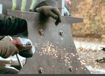

Seeing the latest Ken Block video this morning (seriously!) prompted me to do a little more searching. Looks like lots of folks are basically just counter-sinking them?
<<Seriously, video grab from Ken Block
Seems like it would be simple enough to weld a second piece of aluminum on the back of the plate, drill the oversize hole through the first piece and the bolt-size hole in the second? Maybe not as fancy looking as the video capture, but the same functionality, no?

That picture up at top with the angle grinder - SPARKS? Meaning that sucker is STEEL? I thought I was the only person dumb enough for that.
Re: Yet Another Skidplate Mounting thread...
October 18, 2013 09:20PM
Chromoly maybe? I dunno how much heavier that would be than aluminum. Or how much lighter than regular steel.
Maybe a fluke?
October 18, 2013 09:29PM
Maybe a fluke?
ALL steel and iron is approx 7.9 to 8.1 g/cm3
aluminum is approx 2.7g/cm3
And just for fun, magnesium is about 1.7g/cm3
Bear in mind you never use 100% pure aluminum or magnesium, both are slightly stiffer than old used taffy, most aluminum is 6-105 other stuff and most magnesium is 20-25% aluminum---both alloy with copper and somehow some of the softest metal around becomes stronger than shittier grade of steel (like the steel wheels are stamped from).
Material thickness becomes a significant factor...3 times thick sound horrible but the right aluminum 3 times thicker is stronger than the wrong steel at 1/3 the thickness.

Nice white sparks, maybe its Titanium (the cocaine of metals!)
It can be. Talking with the Msport guys working on the v1.0 HFHV when I was in the octane academy, they said the front and rear skid plates are steel for ballast reasons. They even have mounting provisions to put more ballast weight on them if needed. They basically design the cars to be underweight and then add ballast for balance.
I think that Antony worm guy mentioned it as well and was a sign how screwed he got as a customer car. Where his car had AL skid plates and was still over weight while the factory drivers had steel skid plates with ballast.
October 23, 2013 11:49PM
Well, that's definitely one way of lowering the center of gravity.
Also, upon rereading my comment, I think I meant fluke as in a trick for the video just to look cool.
