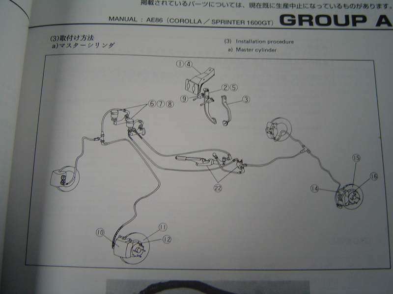

I'm not convinced a new master will help. It seems like this should be easier to figure out than it is. Like that guy in the bmw thread never posted back if switching ever helped. I found a diagram on an old thread here that showed this photo.
That little round thing connecting the two lines after the handbrake is a shuttle/priority valve. I was thinking this was how it had to be done but I don't really know.
