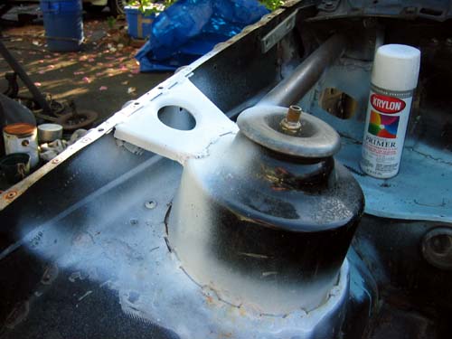

Ill be honest that gusset does not look like its doing a whole lot to me. Maybe it does more for the front suspension which is what that looks like but for the rear I have my doubts. If that were tying to the very top of that tower and if the gusset were deeper then maybe i could see more potential.
This looks much better to me. Helps the force dissipate from TOP of turret especially around the bolt hole to cage. Would probably be even better if cage tied to top of turret.
This is Al kuns car. Again thank you for the photo Al.

Agree that looks better...dooooo eeeeeeat!
But as for the ultility of that cheesoid little thing, ask Skye aka the Administrator cause he was there when we zapped that in (that's his car) and we poiunded on the done side which went THUD and t'other side when went more BOOOOIING!...Same with stich weld vs non stichwelded inner wheel arch---doingg vs thud.
