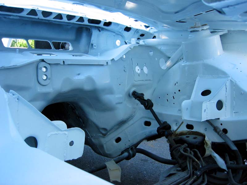

Sump guard mounts and center support
Works behind in blue, copy in front..And that is an exceleent concept to study (strength of materials in compressive loads as a function of height)
Front sump guard mount and combined tow eyelet and integral jacking point:
Gearbox crossmember:

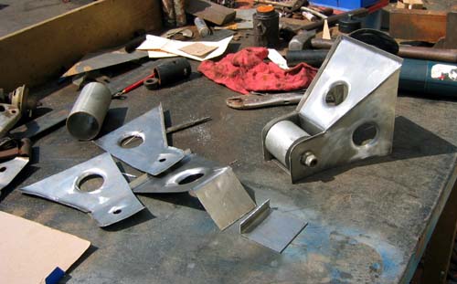

Gearbox mount:

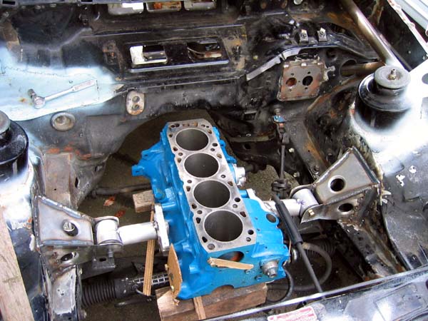

Engine mounts so the engine stays put and is not sitting on the poor crossmember:
That is the way most serious rwd cars were done--in one way or another.
Serious engine mounts

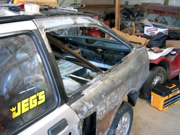

3 door style rear window:
Pretty simple but huge benefits

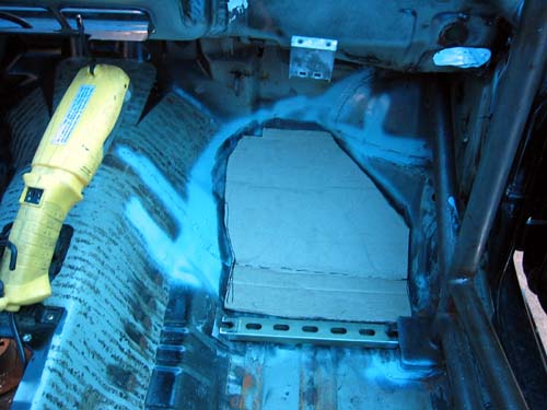

Footwell reinforcements:
