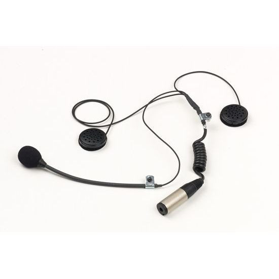

To come in lower with a helmet w/intercom you may need to do it yourself by getting a cheap helmet and adding intercom electronics from Stilo or Peltor.

We've never had any problems with an inexpensive intercom retrofitted into our closed face Bell helmets; think it was a Terracom for open face helmets. We just modifed the side pads to hold in the earpieces so that the earpieces set right by the ears with no glue or velcro; put thin cloth over the earpieces on one. Never fell out in I dunno how many events. Plenty of excess volume and good quality, no failures, and the only noise was when we modified the battery switch arrangement to put it in the ground side.
Glued the boom mic pods with double sided sticky tape on the outside and just routed the little flexi-boom under the edge and inside. The mics have a noise cancellation port on the back side; if you point it backwards, then it will be very noisy, closed or open face. The closed face 'chin hoop' portion helps keep some of the noise out.
SO, IMO, a lot of it depends on how you do it, and it can be done well with more inexpeneive equipment

As far as I could see with the Bell Mag, I don't know if there would be an easy way to replace the intercom system. The bags were fairly square/tight. I'm sure someone could make it work, but when I'm on stage the last thing I want to think about is whether I can hear my co-driver properly.
I did have a rally bud, Mark Biernacki, who did retrofit an earlier Bell helmet with Peltor internals, and he liked it quite a bit. I co-drove for him once and he didn't have any problems hearing me. That's not the Mag version (why pay for intercom if you're just going to throw it out?) but FYI.

Which I have been wondering for a while. Does anyone have any first hand experience of a succesful swap that is comfortable? I have my older peltor, I love the audio quality of it (after using stilos and terratrips) and want to keep it. But I also don't want to end up with a second set of intercoms obviously. So does anyone know of a helmet that meets the new specs while being retrofitable with a Peltor cup system?
Re: Entry level suit and helmet/comm setup?
October 02, 2013 01:43PM
The ear-cups would be the hardest part to transfer if the helmet isn't equipped with them already. Getting a helmet with earcups for rally is probably the best damn thing you can do. Trust me, your ears will thank you after events if you have a loud car but the biggest part is filtering out all the shitty gravel noise.

October 02, 2013 04:02PM
We have both Peltor and Stilo helmets on our shelves. If you look at the Peltor helmet shell you notice right away that the ear areas extend out from the rest of the shell. When we removed an earmuff cups, you see that the ear cups are deep to fit into the protruding ear portion of the Peltor Helmet shell. Looking at the Stilo earmuff cups they are relatively thinner than the Peltor cups since Stilo helmets do not have the ear protrusion of the Peltor. I suspect that is why Stilo is able to offer their electronics kits with both earbuds and earmuffs. Peltor only offers earbud speakers in their kits. The kit that includes Peltor earmuff cups are only for replacing electronics in a Peltor helmet.
So I would doubt you could place electronics out of an old Peltor helmet into any other helmet other than a Peltor helmet unless quite a bit of modifications were made to the Peltor earmuff cups. You do not want to mess with the interior of the helmet. That may create issues with the integrity and safety of the helmet.
