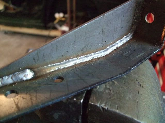

.030 wire. The little welder was cranked all the way up, would thicker wire help with penetration at all? 1/8th seems about the limit of what it can do.
We're gonna get some thinner stuff for other bracketry. This was the first welding I've done with our new welder, my uncle upgraded his welder and gave us his old one on a "permanent loan" basis.
Heres the brackets before being welded with the diff in place, the frame is upside down right now so the top is actually the bottom of the car.
And a close up of some bead action
> can do.
Going up in wire size won't make it run any hotter. The only other thing you can do for more penetration in reduce the Argon content of the gas i.e. if that was with 75-25 gas (75% CO2 25%Argon) it will be a little hotter with 100% CO2. You will get more weld spatter and the arc will be sharper.
