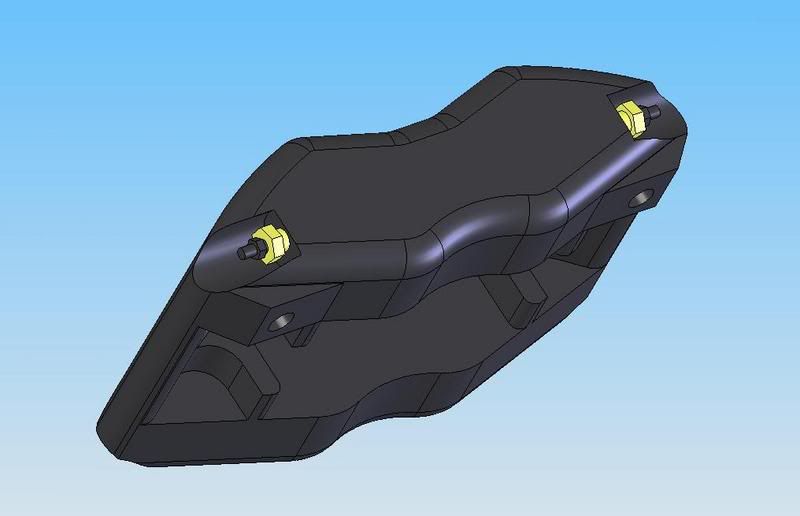

Ooooohhhh, it finally showed up.
Complete with mismatched sides from the spotty quality control at Wilwood...seems they don't run with proper tool monitoring and they let a shitty worn out endmill run for to long. Big chatter marks and crappy surface finish on one side. Obviously it sailed thru the Q.C. department. I put it into electron form last night and to my surprise it's actually a little bit smaller than I expected. Still doesn't fit but its a little closer.

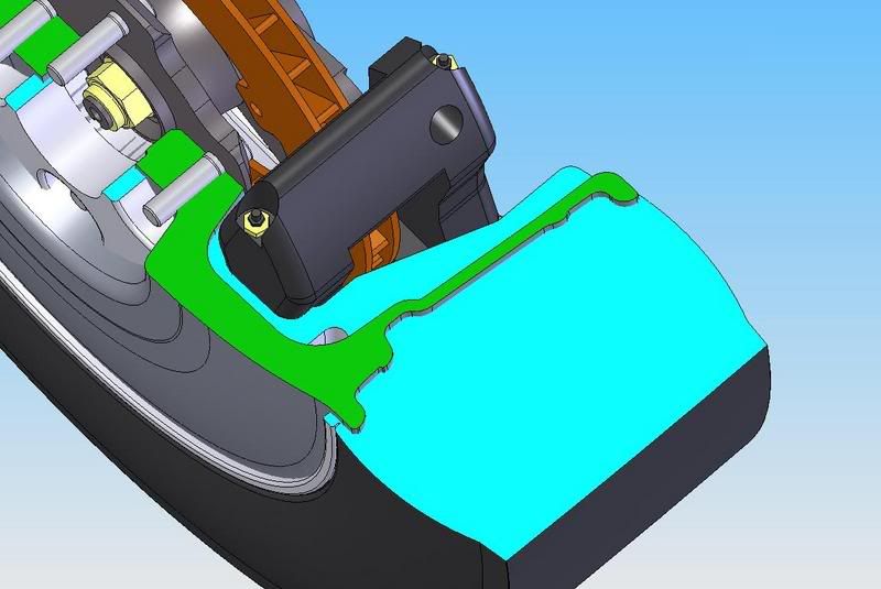

So Chris, I tried soooo hard to keep the 14" rims. Phone dial rims do not like 4-piston calipers...the flat x-section and stiffening ribs just kill all the clearance. Even with the new smaller dimensions for the caliper the best I can do is a 266mm rotor with almost 1" of wheel spacer and comically deep rotor hats. It can be done but not pretty (some would argue that describes the entire car though).

So true...I wrote my slightly irked comment after a 12 hour day of machining satellite parts for Lockheed Space Systems. Strangely they are not willing to accept parts with tooling marks :-)
Hey, since it sort of came up and I'm actually going to have room for them in 15" wheels. What's your take on wheel scrapers to protect the caliper? Sorta cool if you can make them work or mechanism for, prodrive et all, to separate rich wankers from more of their money...

Wheel scrapers it is. Where's the best spot? As close to the leading edge of the caliper as possible or angled with a little more space? I'll make sure to leave a pad on the caliper mount to bolt them up.
EDIT: how about a scraper that bolts onto the caliper leading edge...just a little wedge shaped piece that pinches down the clearance and deflects inward. Then it's a universal part for any given caliper family. Has it been done before, am I late to party as usual, is it just plain stooopid idea???? Hmmmmm

Finally got a drawing out of Compomotive for the rims I want to use. As you can see they easily handle all of the clearance problems I was having with room to spare. The green x-section is a TH3-1560 which is a 6Jx15 rim with 4.92" of backspacing. The blue is my current wheels that will be for sale soon. They have so much clearance that it looks like I can mount to the stock brake ears with only a little clearance grinding.

Jawesome - This compooter business is really neat when somebody knows what they're doing.

No kidding! That would make my upgrade so much easier. This pen and paper business is for the birds. smiling smiley

Your computer design skills are impressive. I rely on reading and lots of thought and math to figure things out.

I'm stoked to see what you come up with and what the final product looks like. The Compo diagram is sweet.
