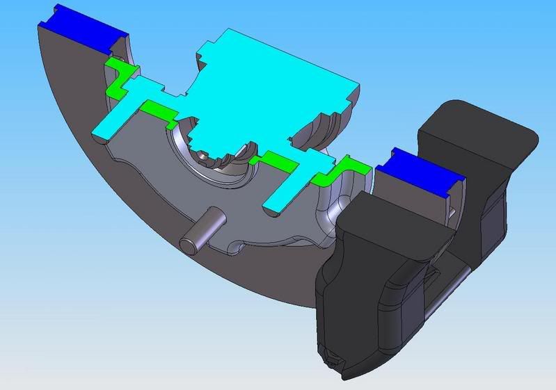

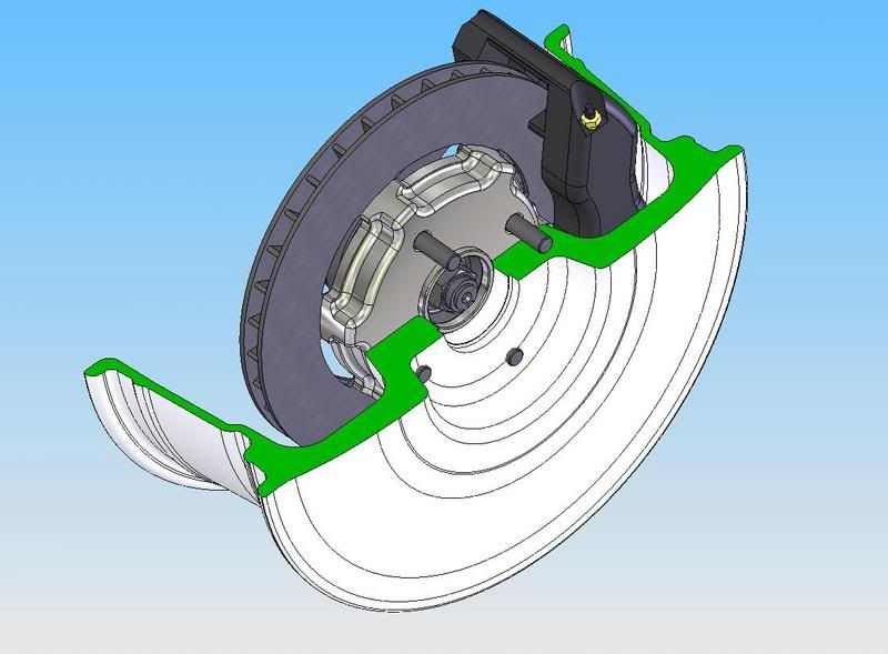

I've been a little lax in working on this because my rims are another 2 weeks from getting off a boat. Thanks to all for the links to rotors. I think I've finally settled on some off the shelf Wilwood rotors 279.4 x 20.6 in the front and 273.1 x 20.6 in the rear. I just did a quick design of the rotor top hats I will be making a few nights ago. The custom hat lets me keep my hub-centric mounting too.
Another huge bonus it they turned out to be really light (1.55lb for the top hat)...right around 9.5lb each for the fronts combination and 9lb in the rear. Hell, that’s over 5lb less per wheel than the brick like Galant rotors I have on the front now. I have acres of room around the caliper so the next task is connecting the dots between the caliper mounts and wherever I decide to mount on the hubs.
I just took another cut at the top hat design...they're now about 0.45lb lighter with almost no difference in stiffness. I love computers when they behave and do what I tell them :-) You can see most of the difference in the outside profile but there are a few more subtle changes too. The billet blanks are getting ordered tomorrow and I'll probably cut some top hats in the evening early next week.

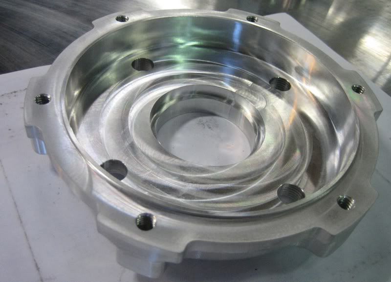

Knocked out OP1 this evening...
Hopefully I'll be able to get the fixture and the flip side done tomorrow.

yo,
good work with the Catia.
I would suggest that
your hats may be a bit thick,
- the rotor should be able to flex some
mainly,
i would not trust rotors threaded into aluminum. nuts and bolts.
if machining cool stuff is your job, I may be able to come up with some bit for my car. are the rates reasonable?
do you trust outside code?

> yo,
I can't afford Catia...just lowly old Solidworks. They look the same though since Dassault bought them out in '97 and they merged the interface.
> mainly,
> nuts and bolts.
They're still to thick because the picture above is OP1 and they get cut smaller on the flip operation. I also haven't put in the helicoils yet. I'll admit it's not ideal but I doubt there will be any problems with them as long as I safety wire the bolts. I debated making the rotors floating for at least a week and then finally gave up when I couldn't do it without custom rotors or a lot more work. However unnatural this mounting method is, it seems to work in a lot of applications. I can always cut them again with t-slots for floating mounting if it doesn't. The billet blanks were only $32 each.

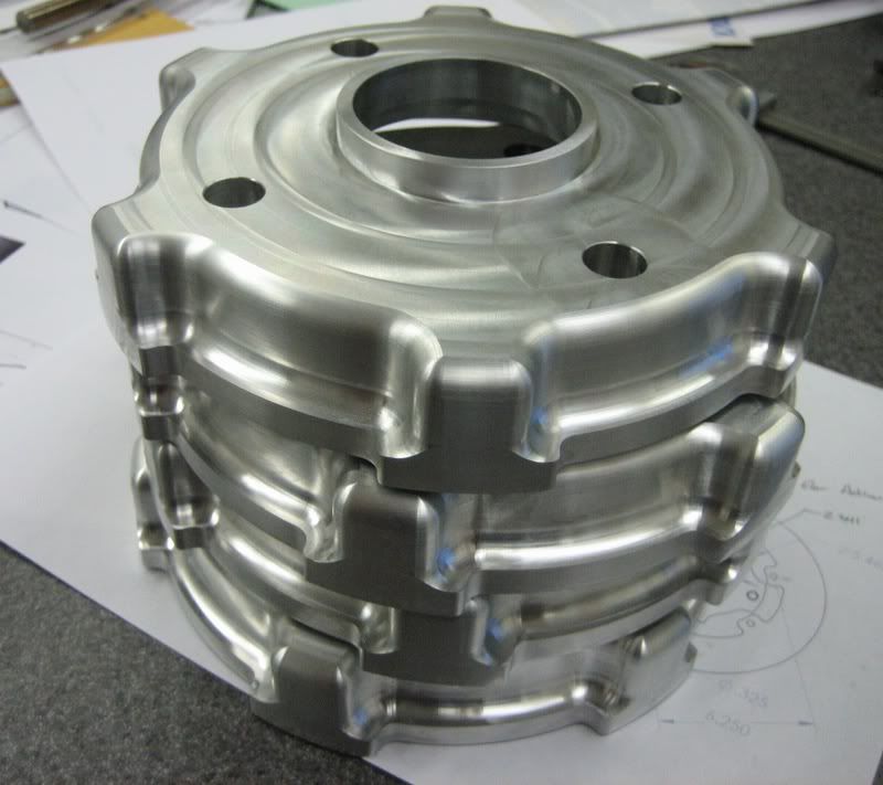

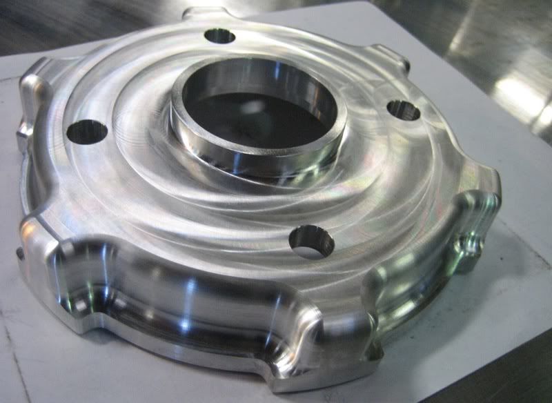

I didn't feel like doing real work today so I stopped early and finished off the rotor hats.
