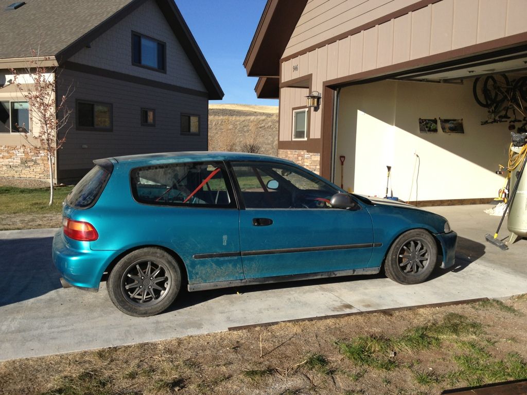

Here it is, in as nearly the same condition as when I traded my old Integra for it. Slammed, I know but that will change.cool smiley

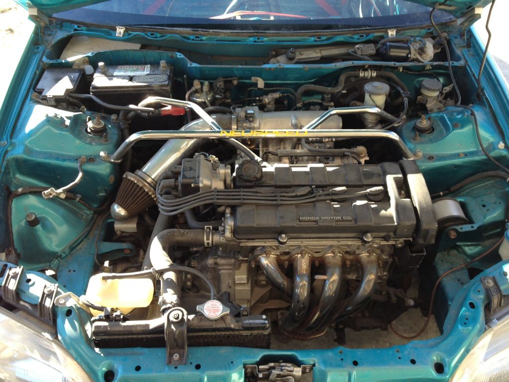

Here is a shot of the LS B18B1 and tranny already swapped. A welded diff is in it's future.

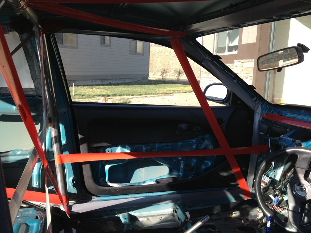

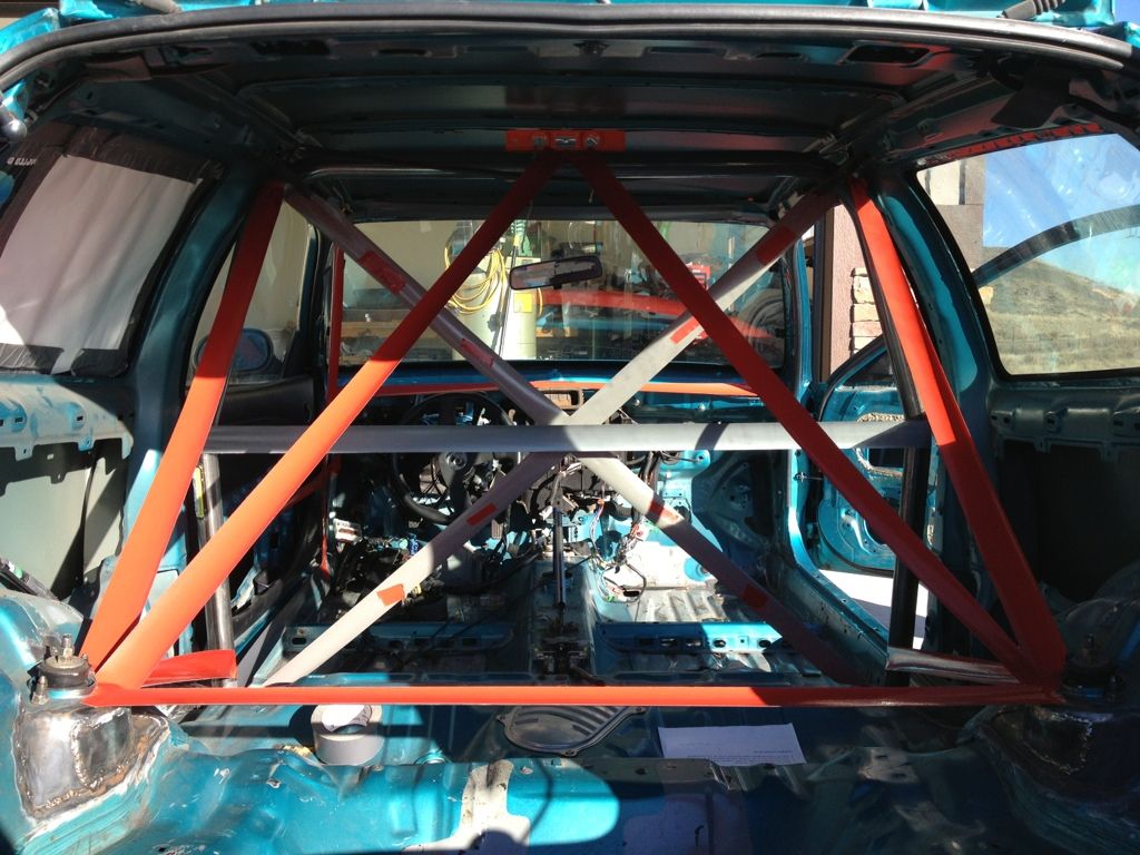

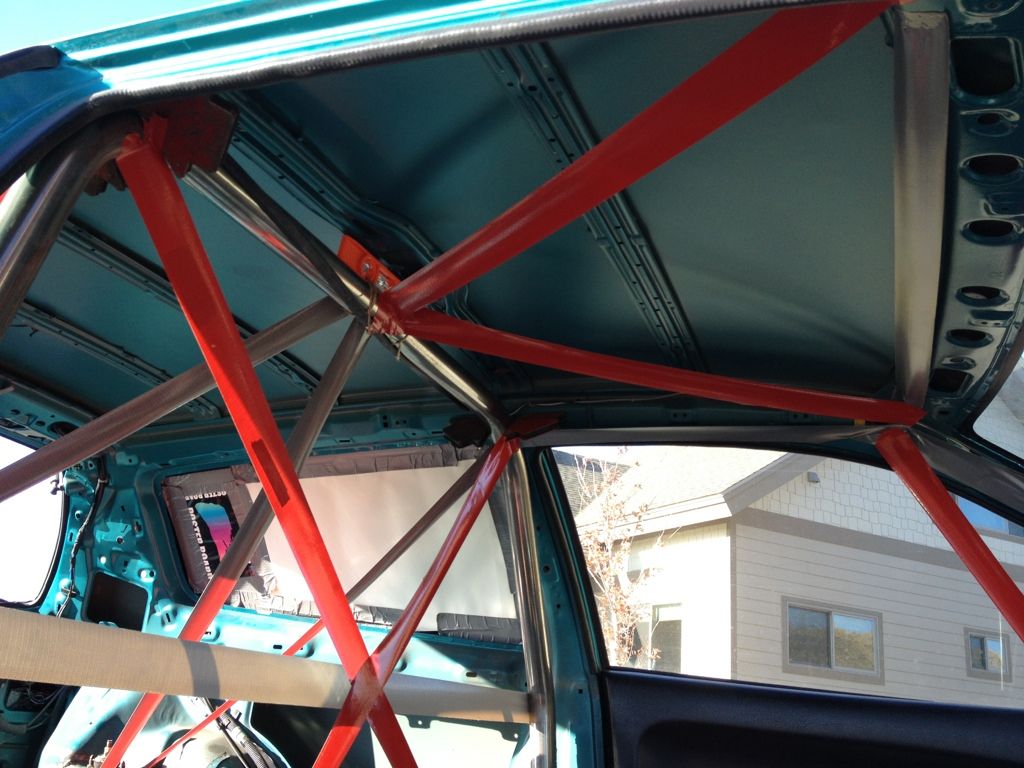

I've stripped most of the interior and chipped out the sound reduction tar, thanks sub-zero Colorado weekend.thumbs up I also did a crude mock-up of the cage with duct tape before ordering some DOM tubing. The main hoop is a Competition Engeneering pre made piece I ordered from JEGS a while back. The 1.75'' tubes are layed out in silver and the red is the 1.5'' tubes. exception: the harness bar is in grey for no reason at all.smiling smiley I used the pdf of the min cage requirements from the RA website.
A shot of the cockpit.

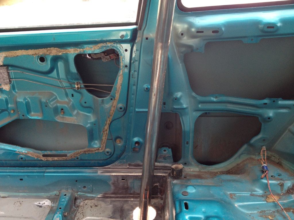

Side hoop and door bars etc. the sill bar is there too. I know there are no gussets, it's tape. tongue sticking out smiley
I only have one question for the ones who have done this before. in this picture the main hoop is in the position that i originally planned for but I was thinking of moving it to where the hole saw is sitting. any suggestions? the giant hole is for lowering the cage in order to weld the top of the roof bars and things.

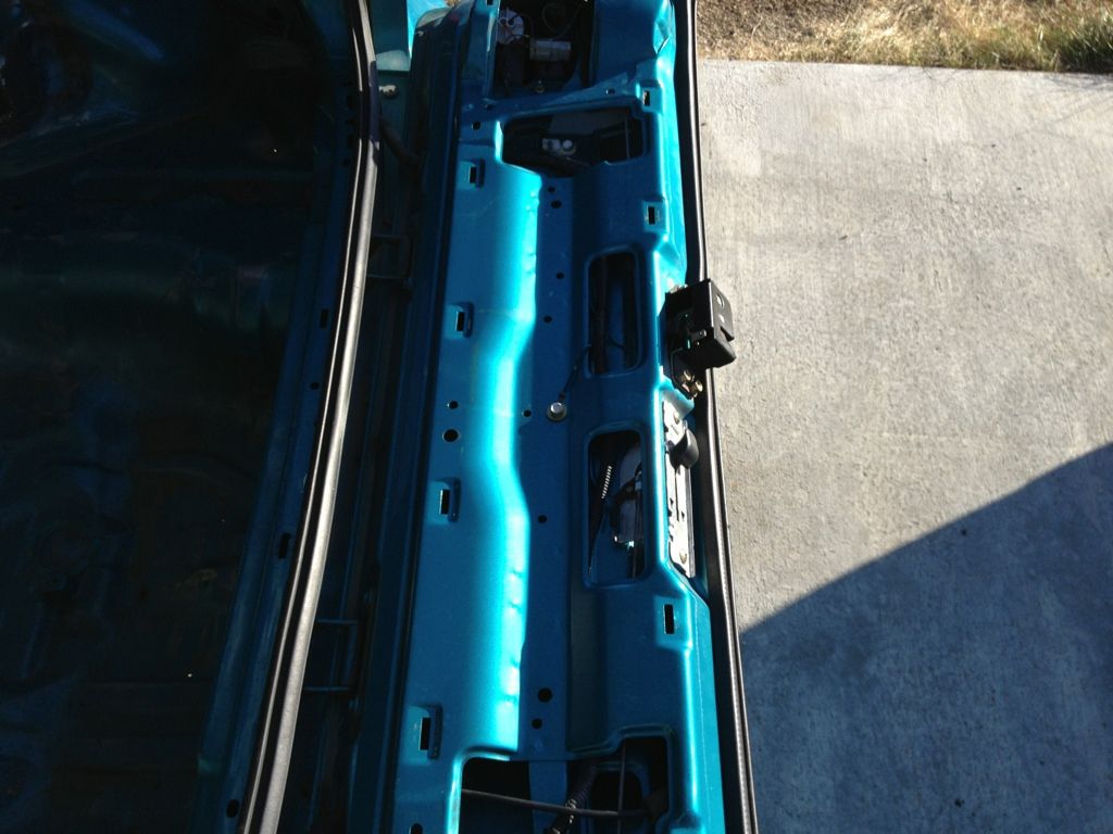

I also have done a sick wire tuck job on the tailgate.thumbs up

Build boxes for the cage feet and have the main hoop sit on top of the boxes. Of course, since you've already cut holes, you'l then be able to get them really really low.
Main hoop is allowed to tilt back up to 10 degrees. 10 degrees at 20" high is 3.5" further back = potentially more room for seat to recline without getting head into main hoop X.
Door bars: Need to be one 1.75X0.095 continuous door bar plus and additional bar. I would suggest doing a sill bar aka 1.75X0.095 as low and straight as possible. Then do a single diagonal door bar. So starting high and going down to the bottom of the a-pillar. This will reduce gusset being required where the door bar and a-pillar reinforcement are.
There is a good discussion about door bars on this forum that I started a few months ago. A short search should find it easily.
A-pillar reinforcement can have up to 20 degree bend but must remain straight in side view. This can be the difference between the bar being 2" from steering wheel to being 5" from steering wheel. And can make getting in and out of car easier.
It can also be a max of 100mm from the windshield longitudinal member. That can make getting in and out of car easier, though with a Civic you are probably okay.

I take the roof off the cars I cage. It takes 20 min to take the roof off.(assuming the glass is out) and about 45min to weld it back on. It makes building the cage 10 times easier and you dont have to deal with dropping the cage threw some holes. The hole trick works but pulling the roof makes the hole cage job much easier. My main hoop is where your hole saw is and ive seen many others built there. I also would build your rotisory first. This makes welding and fitting the cage easier. With the roof off and on the rotisory You dont have to be a contortionist to fit, hold and weld those hard spots. I agree with Billy on the susp build it and rally it! Good luck on the build!
