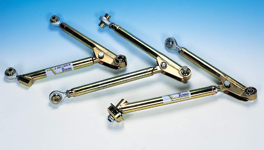

Yep they're certainly green!
Particularly those lower
> control arms. Just a guess, but it seems those are
> a weak point, hence the upgraded ones?
Well they're weak but just how weak is a question maybe Mr "Nothing exceeds like excess" Lane or Brian Hamblin in SoCal could better answer.

I have used boxed Volvo control arms, the Taxi cab control arms (expensive and now rare) and junk that was fabbed up from bits that at the end of the day proved to be much more costly then just buying the good shit from Sellholm and being done with it. I did the wierd stuff on suggestions of certain experts who were just certain that it was a great idea.
My suggestion..... While you are getting up to speed with the car....
Box your 240 control arms. Simply weld a plate to the bottom of the control arm and drill holes so that you can get to the fasteners for balljoints.
Use Bilstien's inserts with dampning values close to what Volvo used in the 552198 R-Sport inserts with springs of 350lb/inch.
The Poly bushings will do nice things in the front end.
Get a Quickrack. John VanLandingham sourced guts for one, I supplied a core and the two were mated together at the rebuilder's in what has been a fine thing for the car. My guts make for 2.5 turns lock to lock. I would do 2.0 turns were I to do it over. My steering rack has required absolutely ZERO babysitting. I love it.
Remove the sway bars and save them for that track day.
Once you are going pretty quick you will start breaking spindles and bending strut tubes.....
Be ready to spend your money wisely. Sellholm has been doing this stuff for a long time and knows WTF they are doing. You are saving exactly ZERO dollars when suspension fails and causes the car to be wadded up into a little ball (ask me how I know!!). You have saved exactly a lot less then that when it happens again cuz you are developing suspension for someone else.
Spend your money once on Sellholm's package and be done with it.
Expensive? Yup. I figure 15 to 25 cents on the dollar for what I have into lost entry fees when shit broke making for a DNF, bodywork, not to mention the reality that the contents of the car could well have been killed when previous efforts at cobbled together suspension, wheel bearings ect failed at three digit speeds.
Spend your money wisely. It will sting a bit, but Sellholm's package is fully developed, bolts into the car and is the end of it. Oh... the car handles well enough to make fine results on old shit for tires after having not been on gravel for five years.

John recently bought some Sellhom 50mm stuff, some rear shocks and some Alcon big brake thing so Sellholm can do no wrong. He told me the price for the total but we can hope that he posts it here in detailed form.
It is shockingly expensive to purchase and the freight was doubtless crazy as well.
Hey Grant, you want to get some slightly used big ass GpA alloy front uprights hubs brake discs and big ass AP calipers?
John has some--which were previously on his car-- and isn't using them anymore.
Well maybe get the uprights and TCA and compression rods.
John was killing the wheelbearings in kit we discussed and made rather than jusdt getting the crazy expensive kit from A1 in Sandy, Bedforshire.
Some have thought that he was crushing them with the big impact gun, too much internal preload, then failure but who knows.

So that the uninitiated will know..... Cobbled into the front of my Volvo was Ford Escort Cossie Gp-A 4X4 front suspension. John VanLandingham sourced this stuff from overseas (UK?). Most parts were used. Dave Clark was hired to install. The AP calipers with big rotors on hats were bitchin' until things started happening. Things like a suspension upright (Magnesium) broke on stage at speed. Wheel bearings failed. John V at the time spoke of a 'Kit' to replace the wheel bearings (The Gp-A stuff was no longer available) but felt that we would do just fine with a wheel bearing that he supplied in a housing that he had made up with a local machinist on a lathe. Wheel bearings failed almost immediately. The failure would show up as the wheel bearing would allow the brake rotor to contact the brake caliper in one corner of the car. At speed when the left-front brake is applied the car will do a pirouette. The car got bent up badly and ended upside down.
Wheel bearings got replaced along with body repairs. Next time out with the car still smelling of the bodyshop it happened again. This time the car landed on the driver's side. The car did then get parked for five years until I could get this solved.
Post failure inspection suggested the failue to be due to geometry issues with how loads are centered in the wheel bearing.
I readily accept my part in what proved to be a series of failures in my car's front suspension and there John.... you have seen it for yourself. John when I screw up I accept that I did so and make every effort at not doing so again. Can you say the same? You will notice that I did not use your name to slam you previuously.
John you got quite a compliment where it fit: The steering rack you did has performed flawlessly.
Point is not that you or any one else's efforts were garbage, but that development can and often IS painful. I learned a painful lesson. I will not be a guinea pig for others development efforts.
John you ask how much? The answer is $7500.00 yankee dollars. Yup, a lot of dough.
The Sellholm price includes 'Ambulance Spindles' (I have never seen an 'Ambulance Spindle' in Volvo parts Fiche and to look at it do not see what is different) including strut tubes with adjustable spring perches, 50mm Bilstien dampners valved how Sellholm wants them, 350lb/in Springs, Helper springs, Spherical strut top bearings, control arms for front suspension as John has posted photos of, hubs with new wheel bearings (used bearing hubs) Alcon front calipers, Alcon rotors on hats, fancy braided brake lines that require elimination of the stupid Volvo 'Dual diagonal' hydraulic circuit which should be done with a rallycar anyway.
Also included in that price is rear springs and Bilstien dampners that I have not yet fitted to the car, shipping and import duty.
John the wheel that I had to 'fuck around to find to clear the brakes' is the Volvo 15" wheel called 'Sirius' made by Volvo and used in 700 series cars. It clears the brakes without modification and can be had for much less then any manner of 'Compomotive' wheel that I'm aware of.
John your customer who purchased suspension for his 240 has found that it makes for 4 degrees of positive camber when installed and called me asking what he should do.
I have concerns about the strength of the joint between strut and spindle + concerns about what happens with loads through the spindle in your design.

I've never run the rally car with standard A-arms, so I don't have a comparison to offer. I would plate both the A-arms and the trailing arms to begin with. The other designs out there are good, but if starting out, just plate them. It's simple and straightforward. I hit a rock at 80+ mph in 2006 with the left front and the A-arm came through pretty well -- I think I could actually use it again. But we broke a spindle. Here's a picture of the impact: http://www.rallybrick.com/imgs/comp_photos/laughlin06/laughlin06_01_450_img_8708.jpg
The Sellholm stuff is very strong -- to the point that it appears that it won't take an impact too well and transfers the energy of an off to the body. Malik's had some problems breaking body mounts with his Sellholm A-arms.
I have Sellholm rear shocks and SAM springs. The combination is very strange when the car is sitting still (it feels like there are no shocks at all), but is absolutely fantastic when in gravel. Very grippy, as the rear end gets squatty. It absorbs the jumps very well, too.
...Brian...
