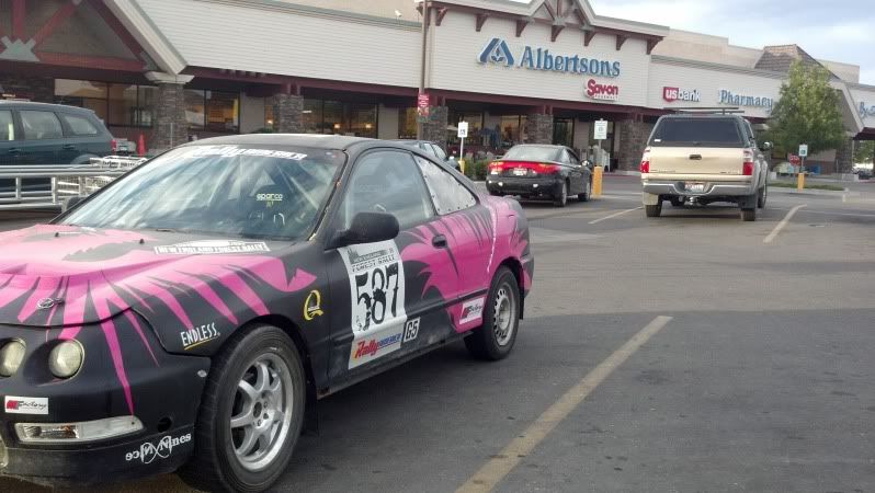

Stopped for some lunch food after tech(before swapping on the good wheels)
You can kind of see how much room I have between the seat and A pillar bar. Also it's not a Group 5 car anymore. It's got a N.A. 97 Integra Type ARRR motor with a B16 trans, MFactory gears and a 4.4 final drive. 65 MPH in 5th gear is between 5100 and 5200 RPM, VTEC hits at 5500 and redline is 8700.
