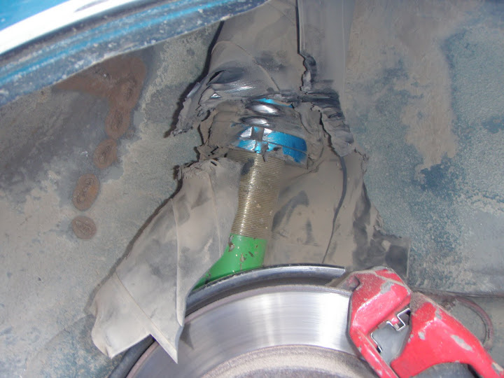

Boys, I have just taken apart the passenger rear strut off Alex rademacher's Subie and man the gawddam ears are BENT FORWARD something horrible.
Mark Piatowski and kevin Turner out East also bent their rear ears FORWARD.
This is NOT something anybody is thrilled about, trust me. But it is flat weird how they are bent and kinda twisted...all very similarly...to similar to be 'random smacking into bad shit sideways' type stuff..
I have suggested that maybe it is the links and arms all moving around so the bottom of the strut isn't "underneath" the top---which is bolted down pretty solid.
But this is screaming that the knuckle itself has done the tweaking.
Now follow with me, we gotta figure this out cause suspension not working sucks...
Everything in suspension describes arcs. It appears that the knuckle is moving up and forward--well it IS moving up, and as it goes UP, especially all the way up, it is moving -----> thataway (looking at Pass. side)
and is mechanically bending the ears...
Can somebody pull off a spring (and maybe pull out the bump stop inside so that full travel is available) and cycle the suspension and watch what going on?
I am wondering if there a big bend moment that maybe easiest way to resolve is with a spherical bearing that accomodates the pivot..
But I am flummoxed...other guys haven't bent stuff like this on same set ups, what's the que paso?

Pics or ban! smiling smiley
Mitch is ripping ears off his DMS at almost every event these days. I'll look closer Thursday and see if it's forward or backward and I'll even take a picture and post it. Might just be a design flaw that will lead to a need for stronger ears and more gussets.

Boys there is sumpin going on, and we gotta work together on this, I don't have a local victim car..
I'll see if i can draw and scan a piccie, AND I'll call the Spring guys and confirm the travel in those 14" springs to double check and try to rule that out...
And I'll see if I can post photo of Alex cause its so dramatic.

This might not help much, since its zoomed in a bit, but here's the only pic I have of that strut while still on Alex's car.
